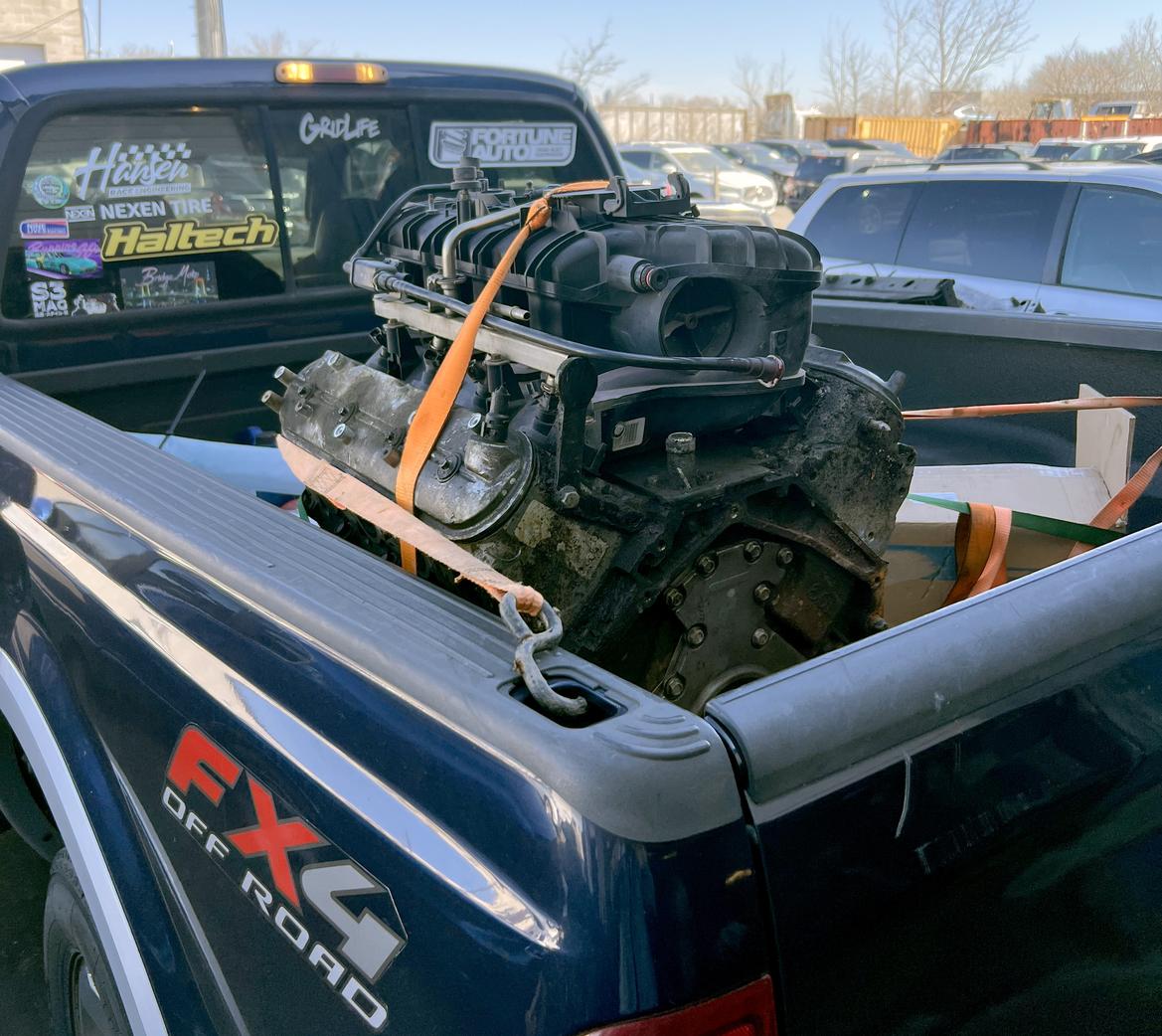

I hit the Philly outskirts after about 14 hours of QuikTrip PB&Js, a handful of Zyns, wristwatch podcasts and willpower. I met Arnold, the guy selling the LY6 at a junkyard, near the water.
The engine was strapped to a wood pallet, leaking a wee bit of oil and maybe sporting some regret.
Ran when pulled,” he said, which we all know is junkyard code for “might explode on start-up.”
I gave him $800, strapped it down like a stolen ATM, and left the parking lot with an extra 500 pounds of horsepower-shaped optimism.

We got to work the next morning, fueled by Cumby’s coffee and the kind of motivation only bad decisions can bring. The LY6 looked even worse under bright lights.
Rust–rust everywhere.
Oil thick enough to be classified as asphalt.
Cylinder 7 had a broken valve spring and slight witness mark on the piston–something we still don’t talk about.
We stripped it to the block, inspecting everything like archaeologists uncovering a cursed tomb. But somehow, it was all usable. Crank was clean. Cylinder walls had a wee bit of crosshatch left. Nothing a dingle ball hone can’t handle.
We broke the golden rule of junkyard LS engines by looking at the bearings. To our surprise, all the bearings looked as good as the new ones sitting in a package on the bench.
Heads were surprisingly solid sans the broken valve spring. We chucked the valve into the lathe. It was true, so we put it back in the head and kept going.
We cleaned, honed, scrubbed, replaced, gapped and torqued. Parts flew in from Summit, RockAuto and Texas Speed like Christmas every day.
Cam swap? Of course.
Springs, lifters, trays and a new timing chain because I like some peace of mind. Every night ended with Long Drink, pizza and the kind of garage talk that cures the soul.
After three days, two near-arguments and some long nights, we dropped that rebuilt LY6 onto the pallet. She looked brand-new. Better than new. She looked right. A born-again motor with one mission: Turn that RX-7 into a rolling thunderstorm.
