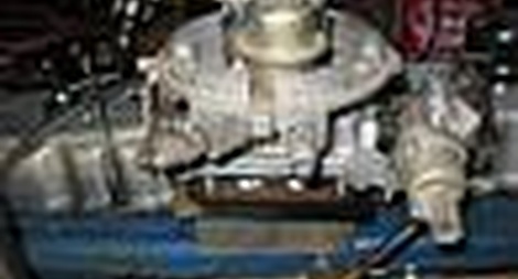

Test fitting FI
Been thinking about an FI upgrade and it looks like this CFI unit would be …
