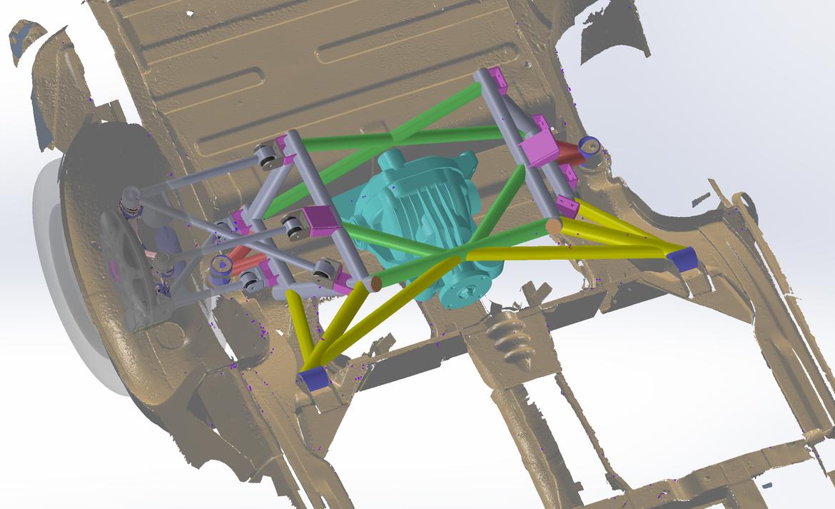

I began a thread on this car on MGExp and I won't bother rehashing everything I have over there, but the short version of it is this. I bought the car about 3 years ago after graduating college as nothing more than a pretty clean shell with plans to completely redesign the front and rear suspension, engine swap it and build what I would like to think the engineers then would have liked to build now. Over the last few years a lot of work has happened in fits and starts as I grew my collection of tools, did design work and worked on things when I could. During that time my professional career in racing has gotten off the ground, I've gotten married and some health stuff, which took center stage for my wife and I, is starting to get resolved. The last few months I've been posting on the MGExp forum my progress on the car has been propelled forwards. Having the accountability to update people, whether they care or not, makes a huge difference. Much of what I post though I think is better suited for this forum and so for a while I'm going to post to both while I figure out where to go from here. To get up to speed I'd recommend reading through the MGExp log here. (Please let me know if I shouldn't link this directly)
The overall goals for the car are front and rear independent suspension with plenty of adjustability, a K series engine and a manual transmission and a total vehicle weight of 2000 lbs without a completely stripped interior. I don't have a huge need for anything be to super original to the car obviously. The car is not intended to be a track-only car but I'd like it to be comfortable there. This means making sure the brakes and cooling are up to the task of multiple laps.
The plan is to start on the rear suspension. This project is as much an exercise in project management as engineering and for this to not take forever I need to focus on one small assembly at a time. I want independent rear suspension and a front suspension designed to work well with the rear. I spent a few months designing the kinematics and few more months evaluating different subframe and control arm layouts in CAD/FEA to dial in the compliance as best I can. Both the front and the rear have the kinematics drafted in, but the rear is pretty much complete. The car will use S2000 uprights and a Ford 8.8 IRS diff in the rear. I just recently this week found a way to get Miata hubs to work with the S2000 uprights, and so it will have 245/45-r15 tires. The track is 55.5 inches which is very close to a Miata and so axles should also be usable with off the shelf options. The design of the rear suspension is nearly complete and the manufacturing is underway. Here are a few photos from along the way so far, I am going to try to update once a week. Let me know if there are things you would like me to focus on, or if you have any questions. Feedback of any kind helps keep this project going.

The miata/8.8 axle option kind of fell through based on price, so I've been looking into other options. Does anyone know if an S2000 housing (to get better mounts and rear cover) with an NB miata torsen or clutch lsd would work? If so I can just run the stock miata axles which would be a lot cheaper and a bit lighter. The only difference on the stubs between the S2000 and the NB is the 26 vs 28 splines, the seal and the length and everything else is the same I believe. Alternatively I could use the 1.8 torsen and an s2000 rear cover and just work something out for the front mounts even if it is not ideal.
IIRC the 2004-05 Mazdaspeed Miata used the S2000 splines in the diff.
As for track width, you're definitely going to need some bodywork. This is stock Miata track width under a GT with 195/50-15 tires on a +45 wheel.
With about 4" of flare.
My car sits at 2400 lbs wet with an LS1 and a T56. Miata front suspension (no separate subframe), rear axle is a GM 8.8 stick.

Your car was no doubt an inspiration for this build just FYI. I think that's probably true for a lot of builds in here though. The possibly absurd track width is going to require some pretty extreme surgery to clear tires, but that's very visible in the cad. If the mazdaspeed axles were more available I'd use those with the s2000 diff and be done, but as far as I know they are the closest thing to unobtainium, is that true?
While we are at it, there is no way that cover in front of the shifter is covering a location the shift lever can be moved to?

I don't know how unobtainable the MSM axles are these days. We used to have a pile of them from V8 swaps, not sure where they are now. I'll see what I can find out. It may be hard to buy a set without also buying the differential, as they're kinda a matched set.
I've never tried to shorten the trans. It would certainly be worth popping that cover off.

Last night I bit the bullet and ordered a lot of things I still need for the rear suspension and drivetrain. All the mechanical parts have now been purchased. I ended up buying an S2000 differential and aftermarket axles from Insane shafts. I also bought some stronger miata hubs, the rear powerlite brakes and soft lines, all the Mercedes spherical bearings and cups from SPC. I still needed the right side knuckle and upper ball joints so those have also been ordered. Going to be very exciting over the next week or so seeing all these parts come in. It's becoming real.
I still don't have a transmission so the complete drivetrain is not in, but I think I will use the NA generation 5 speed. That has an easily relocatable shifter apparently that just requires shortening the selector shaft and moving the mounts forward. It retains all the normal features without modification. That will help a lot in getting the engine as far back as possible without ruining the ergonomics in the driver seat.
The laser cut sheet metal parts order for brackets etc. still needs to go out but that needs some more design work before it is ready and I need to find a way to turn the lower ball joint taper cups. The final pieces at that point are the fasteners and poly mounts. Budget-wise everything is still looking to be ok, so a slight sigh of relief there.

Still waiting on getting a whole bunch of parts in but I did get a chance to hang the engine in the engine bay. I know it's as empty as it will ever be, but honestly it doesn't seem like to tight of a squeeze. I'm a little worried about how to get it low enough, although I didn't have the engine canted over when I put it in for a trial. The oil pan is very low when the engine is at the height to clear the hood even with the engine hard to the back. I have nothing against a hood bump to clear, but I'd still like to get the engine as low as possible. I pulled off all the harness, accessories and clutch which required a couple trips to the store to get the right sockets.
I wanted to confirm the clearance to the fuel tank so I scanned that in. Took a while to get it cleaned up and into the cad, but it should clear ok. I don't think I will use this specific tank though as it has been pretty damaged both from impacts under the car and when the car was slightly rear-ended.
Once parts for the control arms and upright assemblies come in this week I will start jigging the control arms together and assembling the uprights. Once the diff comes in I'm going to see how it fits in the subframe in real life and see what I want to do for mounts. I may just scan it and work with it that way. It's the stock s2000 diff so it has the nicer forward mounts compared to the miata part.
I confirmed the axle plunge in Susprog3d and I think I'm probably alright. I don't know the max plunge available on the mazdaspeed miata axles though. I can always limit the bump to 2 inches if I need to.
