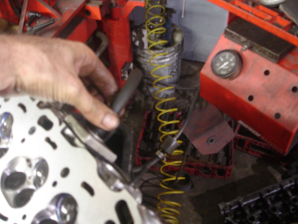

I wanted to make sure I didn't have any problems , so I chased the spark plug threads just in case.

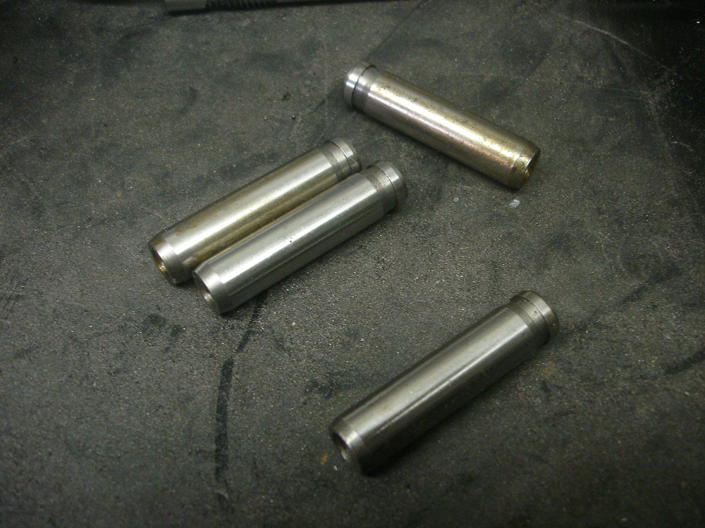

Next I moved on to the exhaust side and CRAP!
I should have caught that when I cut the ex seats. That means I have to replace the guides. And that means I'll have to recut the seats I just cut because they will be just a little bit off.
I banged the old ones out with a hammer, and banged the new ones in.

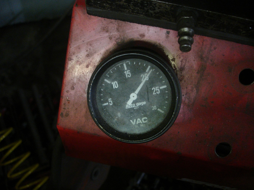

Got it all assembled, and tested on the vacuum testing machine. It pulls a suction on each port to test how well the valves seal. Perfection is 22, so I want to see 20 or better.

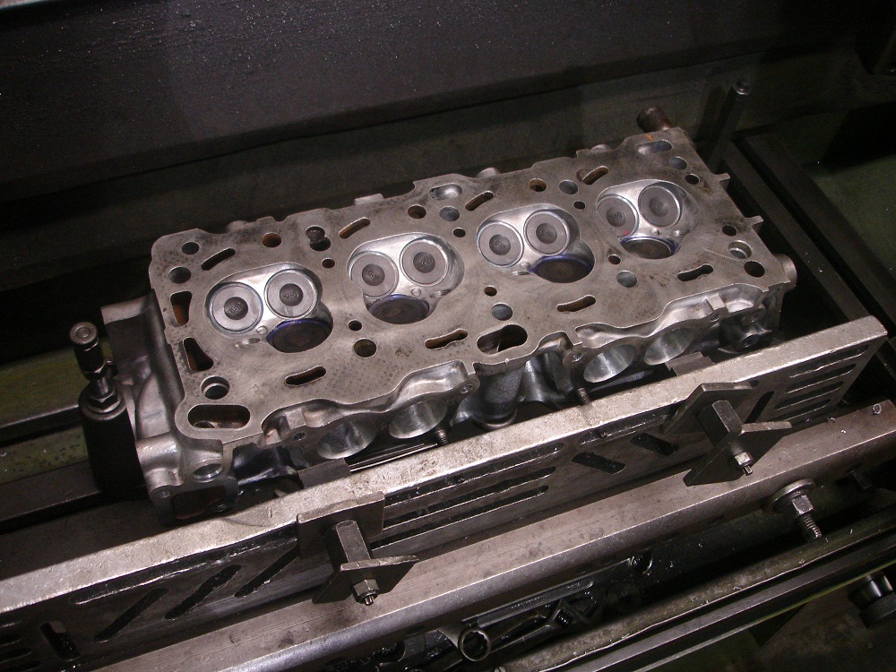

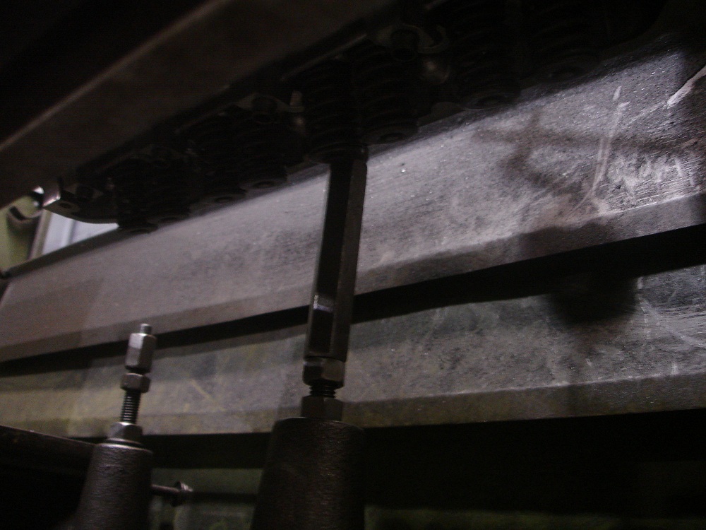

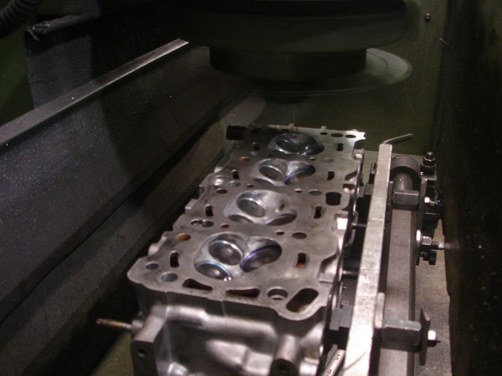

I bolted the head to the machine. It is the best machine in the shop. It uses a diamond bit and a cutter head spinning as fast as a female ice skater. The cutter head stays in one place and the table slides back and forth underneath it. This is the head bolted to the cheeses board.
I ran a dial indicator back and forth along the head surface to check for level while I adjust it. A screw jack is used underneath the head to level it font to back.
The machine on and turning.
The head was definitely warped. Notice the shiny freshly cut section to the left and the dull uncut portion to the lower middle.
3rd pass notice how it is starting to true up on the far right All done. So pretty.

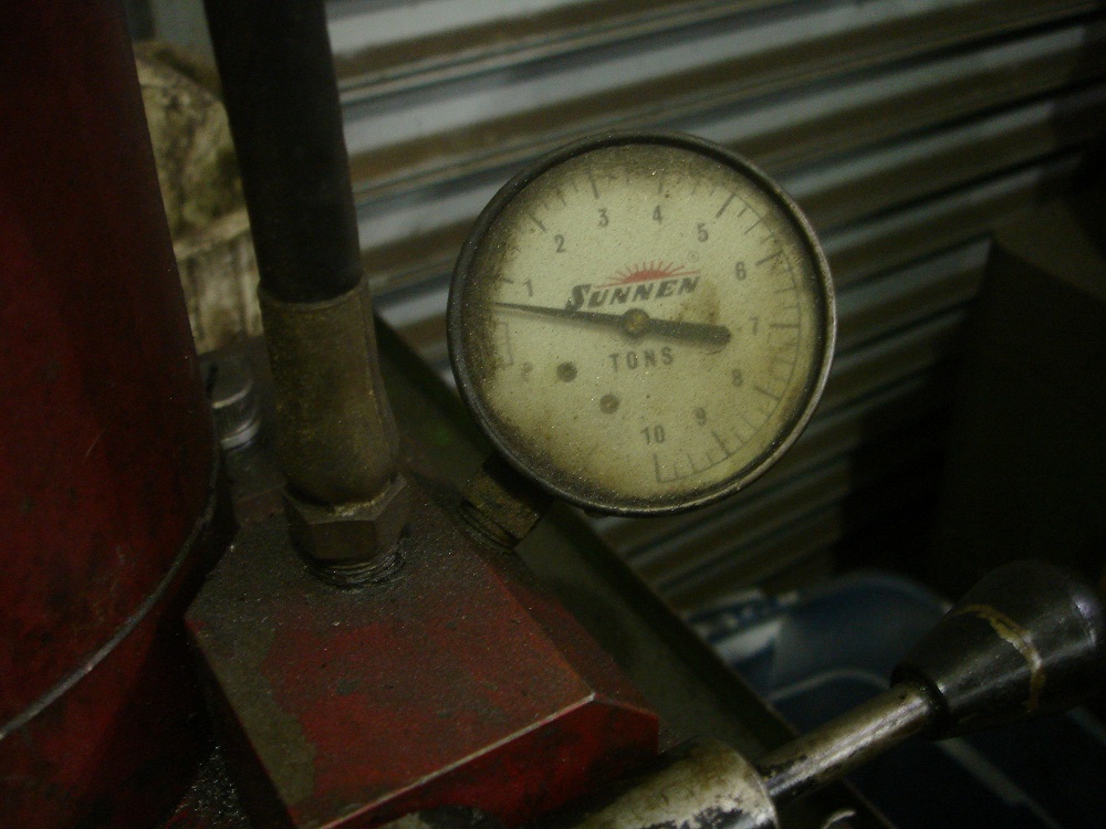

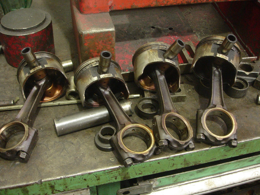

This is the piston press. It uses a hydraulic pump/press to push the pin out of the piston. There are various fixtures to accommodate all the different sizes and styles of pistons and pins. This is the scariest machine in the shop. You'll set up the piston on the fixtures and start pressing. Down comes the ram. The pump changes pitch as the pressure increases and at the climax, around 4 tons, it goes BANG! and one of two things happen. Either the piston explodes into several pieces, or the pin jumps through with a hop as it presses out. You never quite know what will happen.

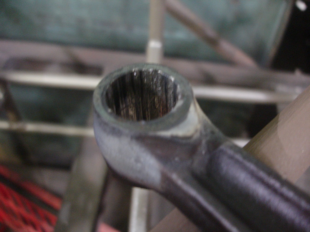

Well mine wound not press. I've NEVER had a pin not go all the way through. The machine normaly works at 4 tons, so when this thing went all the way to ten tons, I was freaking out and standing way off to the side because I just knew it was going to explode. But nope.
Since it wouldn't go and I had to get them off I decided to put some heat on them. This was a mistake. The heat caused the pin to gaul and ruin the rod. So I pressed them on the Big 20 ton press.
Then I bought some used rods....

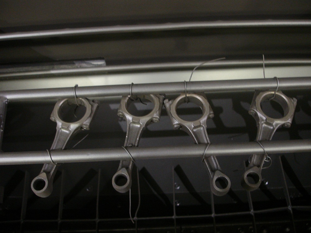

This is the blaster. It slings steel shot while the parts are rotated inside the machine. They say it helps relieve molecular stress on rods and strengthens them. I just like how clean they come out. Rods before Rods after

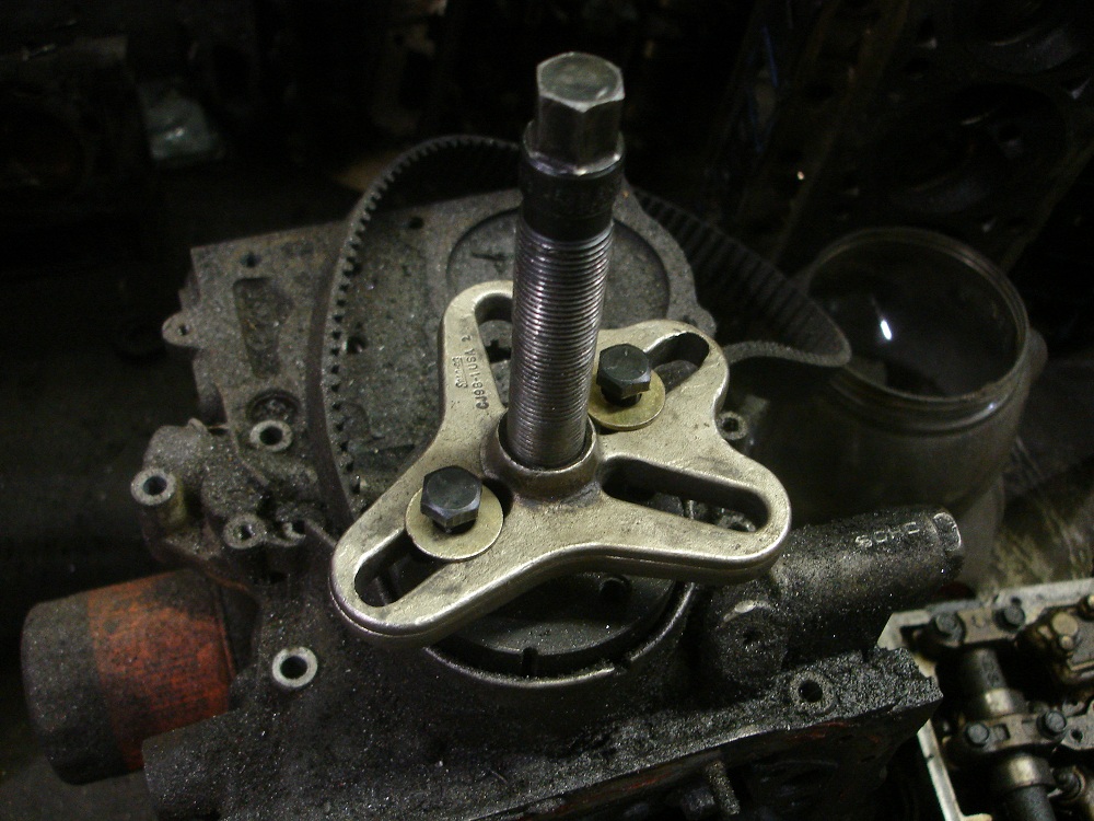

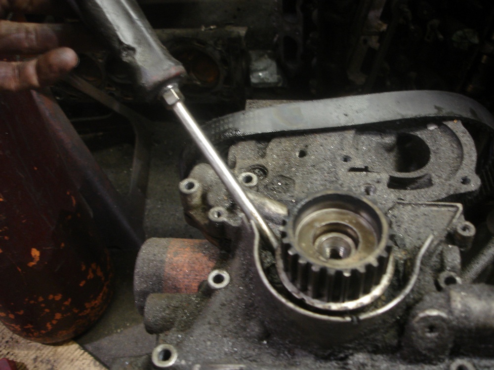

I was told that I could just pry off the balancer with a screwdriver but it wasn't happening. So I got out the trusty balancer puller
I was then able to pop the gear off with a screwdriver

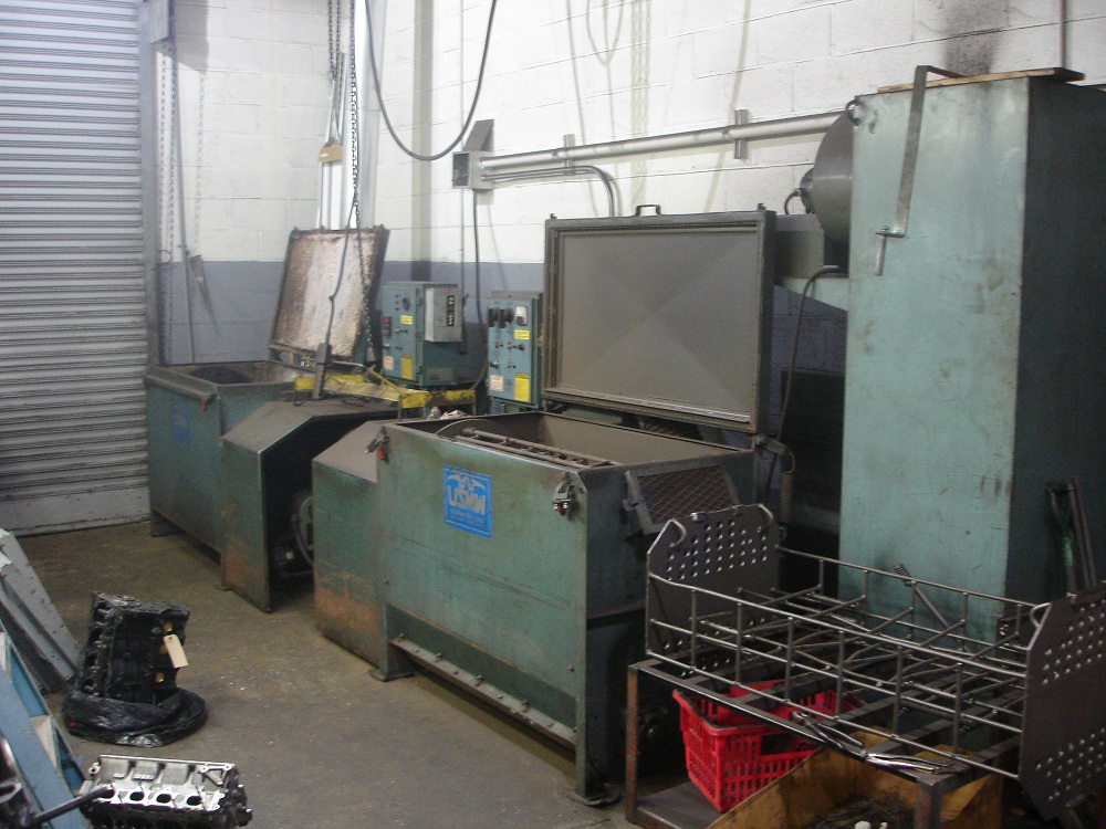

The same machine I used to clean the rods will be used again, except I'll be adding a step. The machine on the far left is a cooker.
It heats the engine parts up to 800 degrees and turns all the old oil and sludge crispy black. Then you put it into the blaster to knock all the crispy bits off and it looks like new metal.

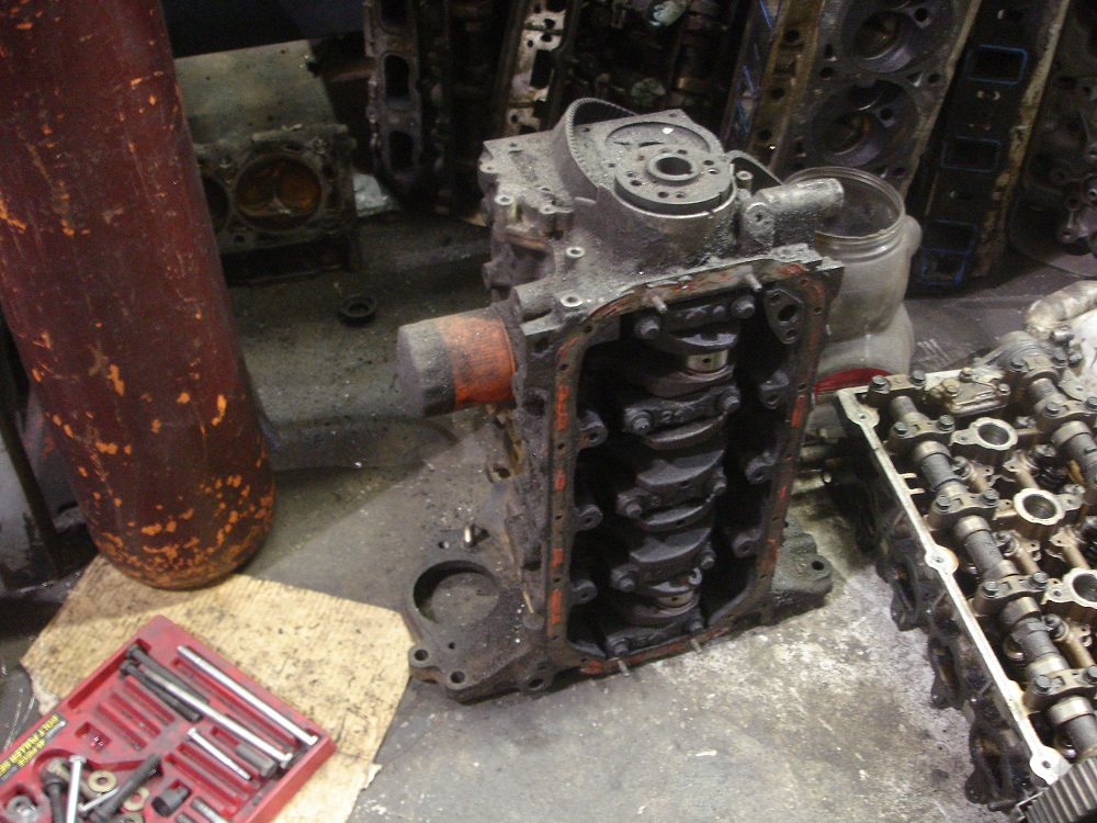

The Block striped and wired into the basket. the "Before" shot After:
Now that it is clean I need to drill it for the turbo oil drain. The 4XE1 block is used in all models including the turbo model. So there is a place for the oil drain, I just have to drill and tap it. a 12 point socket will turn a tap in a pinch. View from the underside

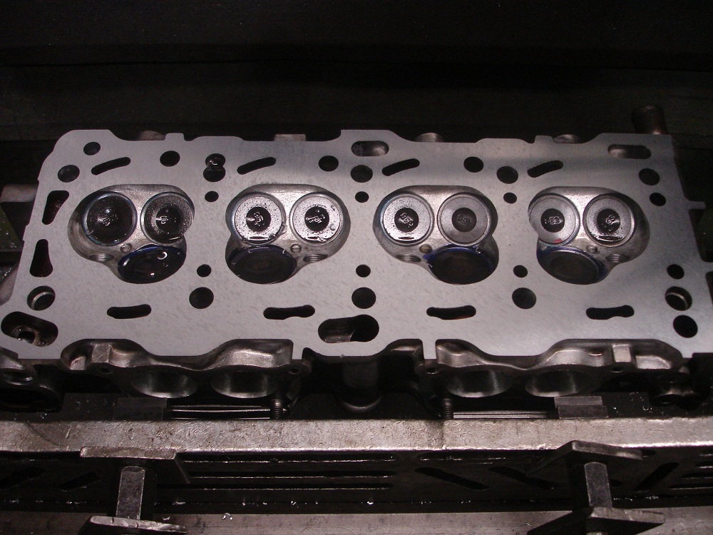

Time to deck the block.This is the same machine that cut the head, except the fixture is removed. I used the clamps on either end to hold the block in place, and the pink paper to shim it level. The before shot
The machine on and turning After So nice! This is a chamfer cone. It takes the sharp edge off the cylinders so the rings will go in.
I took a minimal amount off. It cleaned up in two passes. But I can now feel good about turning up the boost!
