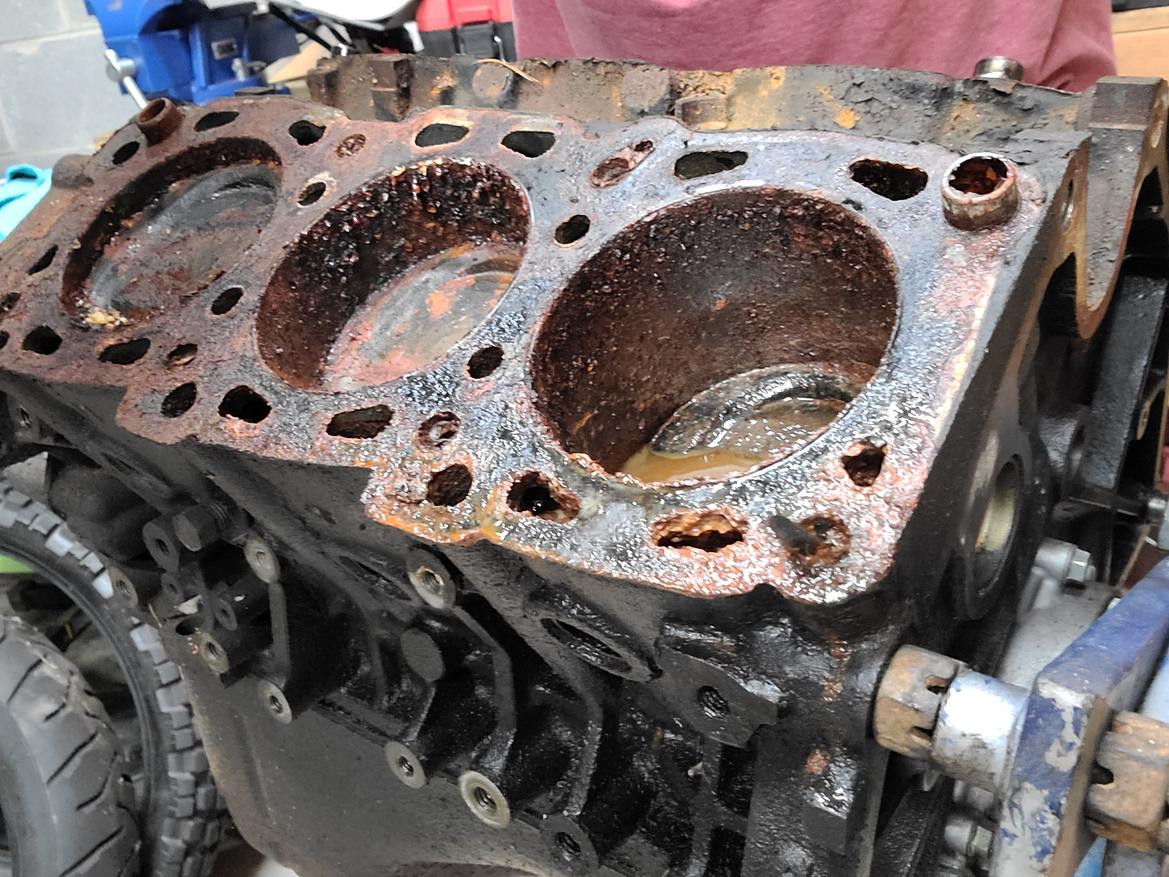

Finally tore into the spare engines I picked up. The seized one was first. As I drained the oil pan, about 10qts of water came out before maybe 1qt of nasty milky oil. One head was missing a valve cover, cam, and rocker shaft but the other was still all closed up. Popping off that cover revealed a nasty, rusty mess of milky oil and neglect. I knew this engine was trash, the guy tossed it in for free when I bought the other one, but I wish I hadn't taken the offer, this thing stunk up the garage.
Pulled the heads off and was greeted with this:
I could not get the pistons to move at all, even with a hammer. The other bank somehow survived in decent shape, I was able to access all the hardware and pulled the rod caps and pushed the pistons out on that side. The nasty side took some time but I was able to get all the rod caps off, hammered the studs out of the rods, unbolted the main girdle, and finagled the crank out with the other 3 pistons still stuck in place.
All the main and rod bearings were in great shape. The singular cam was pretty scored though, as was the cam journal and the rockers had a lot of rust. Crankshaft seemed ok. I'm going to keep all the salvageable parts at least.
The block was DONE. That rust had eaten through a significant amount of cylinder material, not to mention how bad it looked inside the water jacket. At least a few parts were salvageable.
