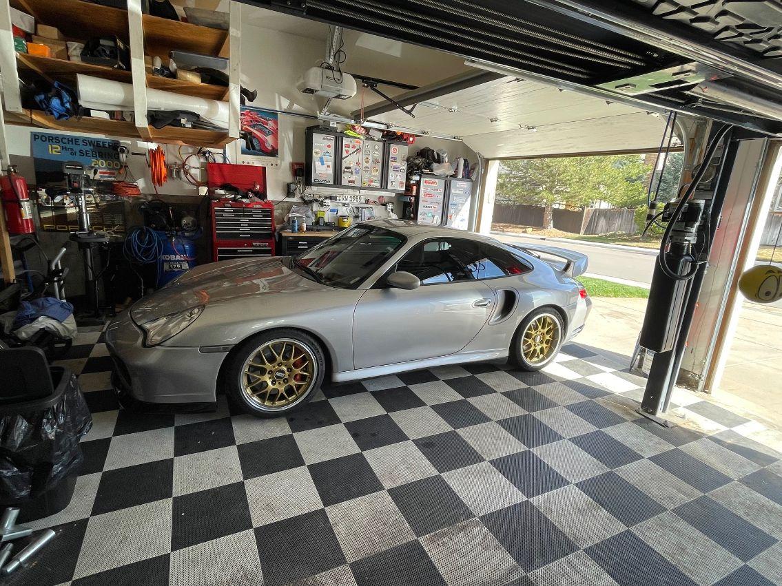

Quick question.  We are moving to a new house soon, and I was wondering about your floor tiles.  Any regrets?  Does the lift create any issues with those?

Well, they're the perforated tiles, not solid ones.  So they're great in the winter, never get slippery with water, snow, etc.  However they're impossible to clean because of that.  If I pressure wash them, it picks up dirt from underneath the tiles and they're just as dirty as when I started.
So I kinda wish I'd gotten the solid tiles, that way I could pressure wash them and then squeegee the water off.  No issues with the tiles and the lift, that's fine.
I might swap these tiles out for solid ones, but didn't really want to unless someone wanted these first.  Let me know if you'd like to come and check them out...
