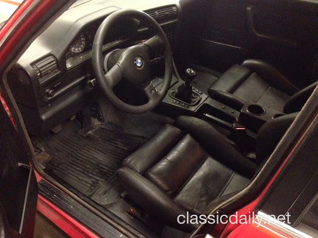

This car is also getting some interior upgrades. First going from tan to black. Dyeing the carpet....1st step is to clean it a ton

Seats getting heat added.
Black vert sports

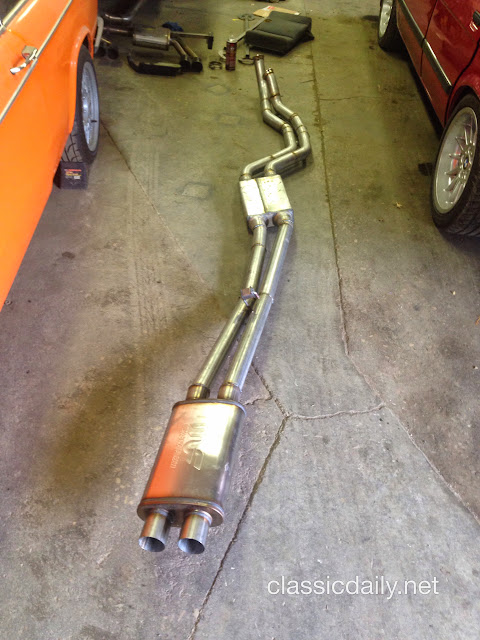

Exhaust...

Once again... NICE! Does one of those mufflers have a shared chamber or does the S54 like a "true dual" exhaust setup?

The center muffler has a shared chamber

Relevant to my interests, why the different muffler designs in center and rear? What is that center muffler?

The center muffler is a spintech. The idea using two different types of mufflers is each one will cancel different frequencies. At least that is what the guy that makes the spintech mufflers said. Makes sense to me.

Pictures before it went back to the owner. We swapped from tan to black sport interior, aftermarket seat heaters, new dash, dyed carpet, 1 series winter mats, fixed sunroof, etc etc.
