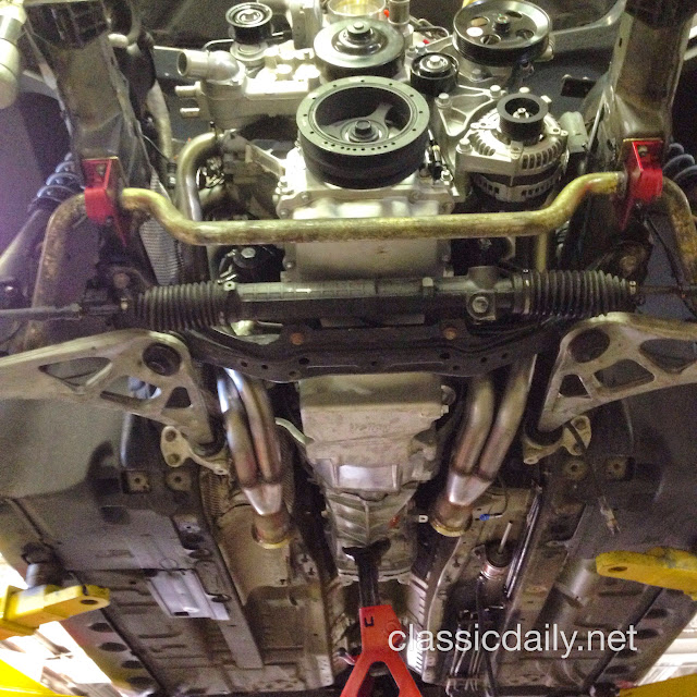

This project is actually running and driving now but I will post the build over a few posts and get it up to date.
Here is the victim. Already has stoptech brakes, coil overs, ground control sways, te37 wheels, super sprint exhaust etc etc
On a lift coming apart
This is getting a 0 mile 525hp GM Perforamance Parts LS3 with a built t56 magnum from D&D Performance.
lightweight flywheel
Engine in (using vorshlag headers)
More to come soon

The e46 is know to have issue with the floors cracking or ripping out so it's best to add some reinforcements. We went with the plates from redish Motorsports out of the UK. These are nothing short of amazing. REALLY well designed.
Start by cleaning all the undercoating off.
The plates
weld/bend/weld
Smooth out and put etching bare metal prep on them.
https://lh6.googleusercontent.com/-7_mWlMKyM08/VDmqEGOwhVI/AAAAAAAAPrg/VcEai7ptwTw/s640/IMAGE_2121.jpeg
POR and seem sealer
Then undercoating
Rear subframe also got new poly bushings
subframe back in

The AC compressor that is made to fit this engine didn't have ports that would exit in the right spot. The trailblazer SS compressor has them on top and there is an available adapter to fit on it. But the issue is that the bracket made for the compressor doesn't match the belt spacing for the engine. So after looking around at other options the best option was to just make a bracket.
Welded AC on fittings to the E46 lines to work on the Trailblazer compressor.
AC lines in place
Tieing the headers into the super sprint exhaust system.
Took a while to find a oil cooler adapter that would fit. After trying a couple different ones with thermostats in them the only thing that would fit was the stock adapter from a truck.
Heater valve was a BIT close to the headers and not much room to run any lines so we moved it up some.
Had the wheel color changed a bit.
Outside for the first time.
