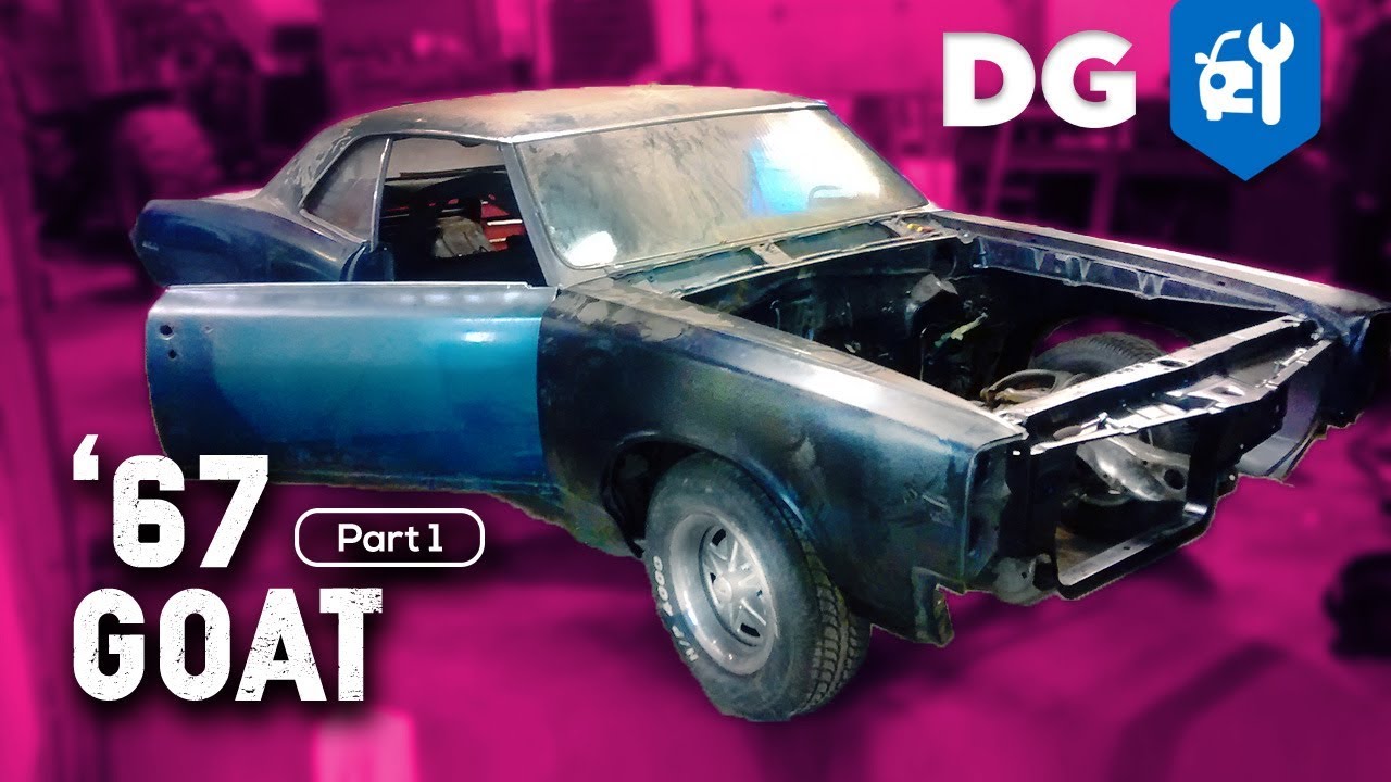

This is an ongoing project that we're documenting with videos. A 1967 numbers-matching Pontiac GTO coupe with a 400 big block.
Part 1
0:06 Build Up Project Overview
5:35 Straightening The Frame
6:00 Mounting the Body to the Frame
8:20 Recap, Coming Up

Nice! That's one of my favorite years for the GTO. One thing...as a long time Pontiac owner and enthusiast,I have to say there's no such thing as a 'big block' Pontiac engine, they're all physically the same size (except for the 301 that was sold at the end of the line, which has a shorter deck height.)
filthyrich
filthyrich New Reader
1/16/16 9:28 a.m.
stuart in mn wrote: Nice! That's one of my favorite years for the GTO. One thing...as a long time Pontiac owner and enthusiast,I have to say there's no such thing as a 'big block' Pontiac engine, they're all physically the same size (except for the 301 that was sold at the end of the line, which has a shorter deck height.)
Thanks! I think because the banks lay lower and leave very little room beside them, it aesthetically looks like a BB from the outside. It's been argued so many times I lost track. I almost had a fight at a car show between two guys. I thought it was funny. In the end, the big block enthusiast argued harder so I figured he deserved me to repeat that it was a big block. Otherwise that vein in is forehead popped for nothing

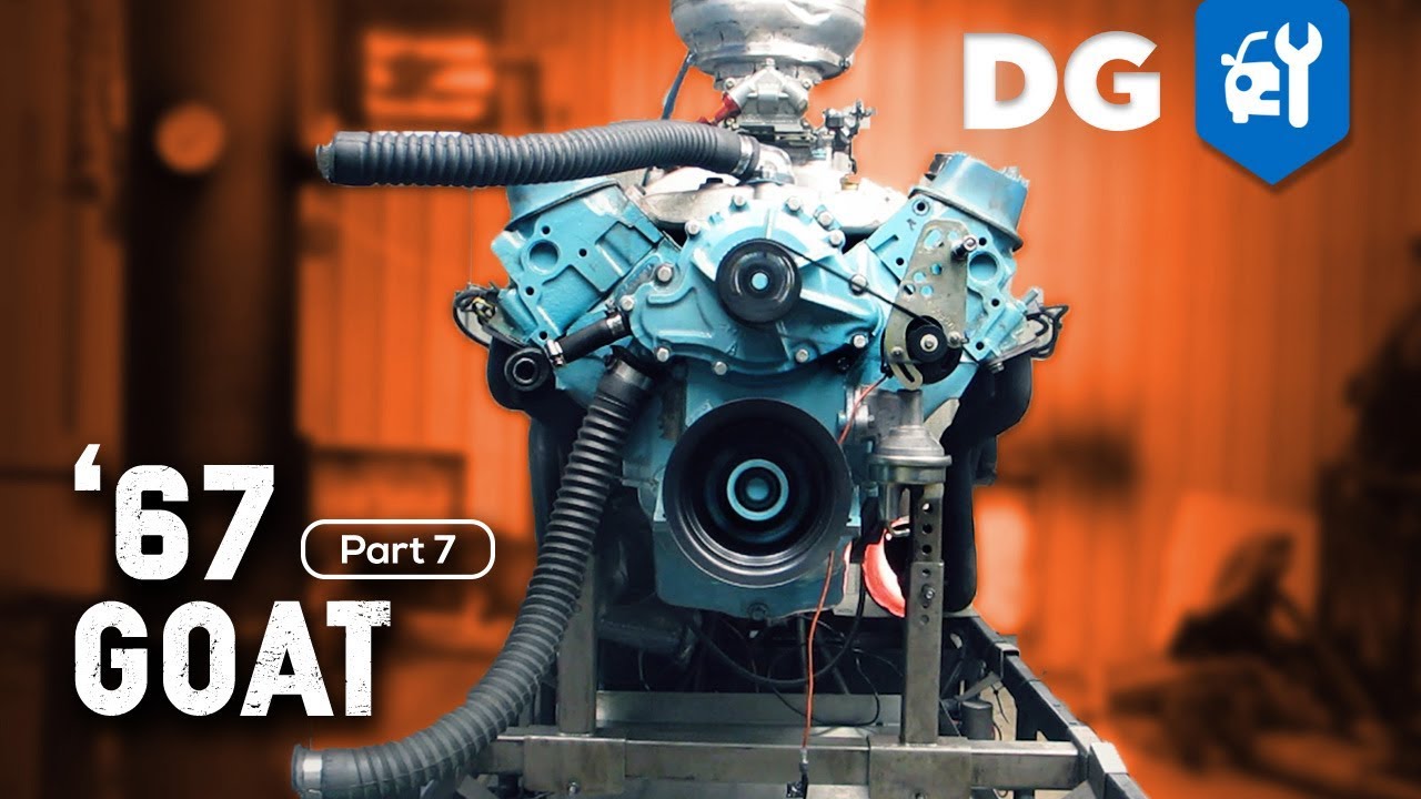

Part 7
We place bets on the '69 Pontiac 400 engine dyno with their tried and tested Holley 650 vs our Edelbrock 750!
Special thanks to DSE Performace
00:06 DSE Performance Inc.
00:44 Finding Leaks
01:21 First Run
01:51 Holley 650 Carburetor
02:45 Holley 650 - 1st Pull
04:16 Holley 650 - 2nd Pull
05:13 Holley 650 - 3rd Pull
06:02 Edelbrock 750 - 1st Pull
07:00 Edelbrock 750 - 2nd Pull
08:30 Dyno Results
09:23 Who Won The Bet?
stuart in mn
stuart in mn UltimaDork
10/25/16 7:52 p.m.
Not bad, it should make for a good street engine.
