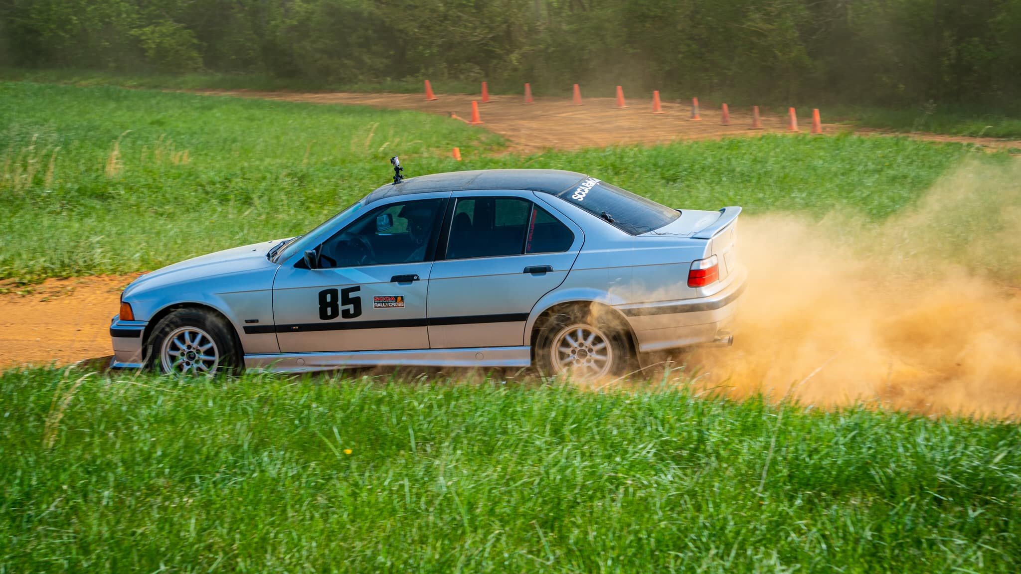

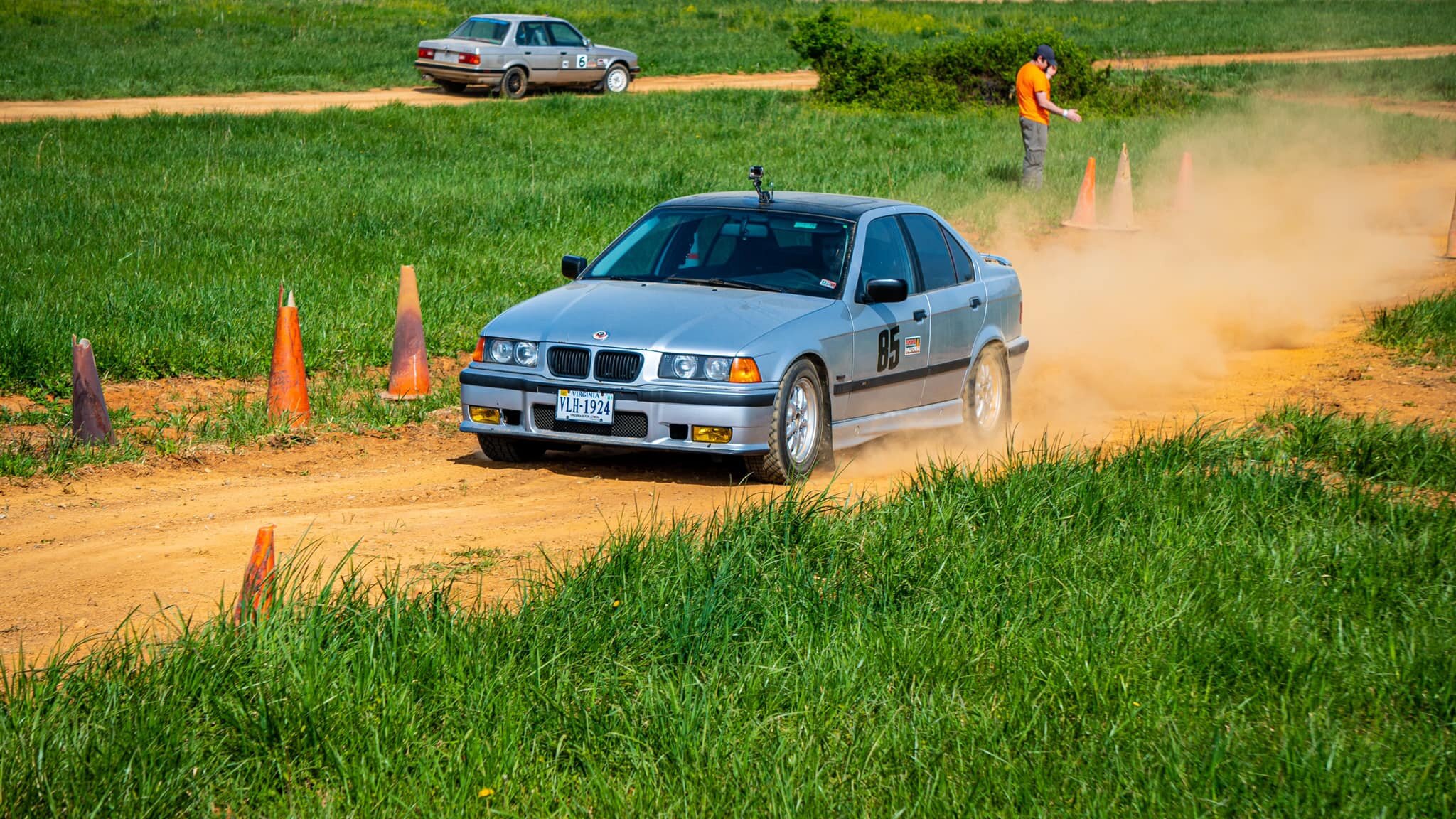

Here are a couple pics from Jeramey Kwan.  I finally reinstalled the stock bumper after realizing it didn't sit any lower than the non-M bumper.

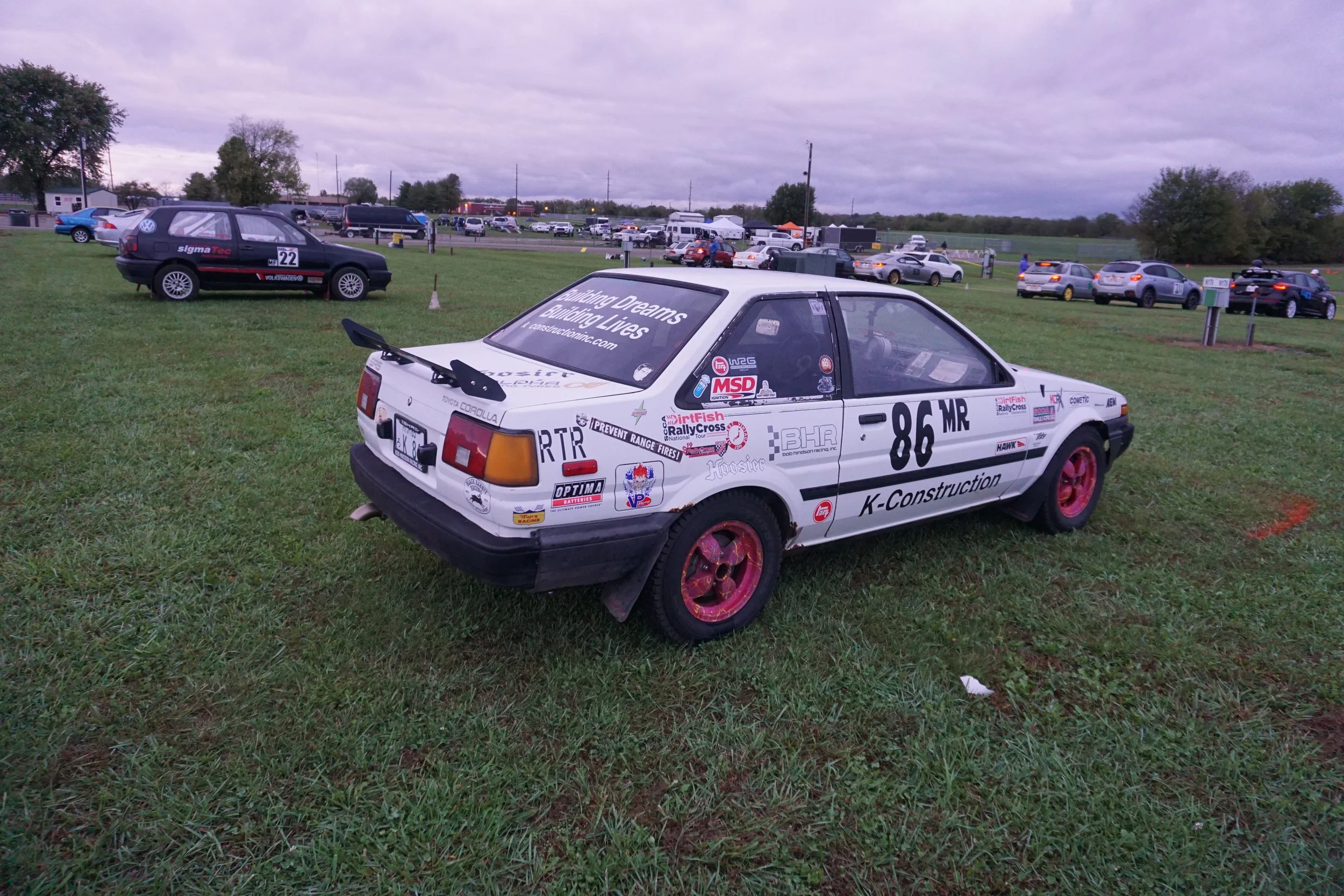

8th
Ryan Redenbaugh - 1985 Toyota Corolla, not sure of mods, Alpha Eurocross
Saturday AM- 5th place
Saturday PM- 8th place
Sunday- 10th place
