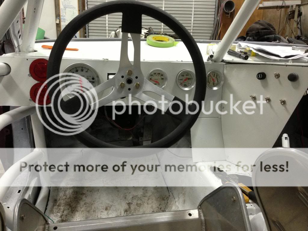

Spent some time installing the guages and switches. Big red lights are the idiot lights for oil and water. They are only 2 inches and should be in a rubber grommet, but I used the wrong holesaw bit. Crap. So I JB welded them into a couple of big washers to take up the space. They are painted red because that was better than the previous rust color, and because I still had the red paint can on the roof from doing the battery box.I have them on the far left because this is mostly a roundy round car and I spend a lot of time looking in that direction.

If you look on the dash the top left knob is the brake bias control. I had this adjustable unit on the shelf since forever, so I put it to use.
<img src=" photo IMG_0413.jpg" />
Its not meant for installing in a dash so I took a drill bit extension to move the control knob and bolted the valve to the underside of the dash.

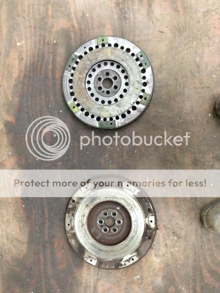

Dropped the stock flywheel off to a machinist for him to lighten. He went to town on it and this is the result. Haven't weighed it yet, but I guess around half of stock.
