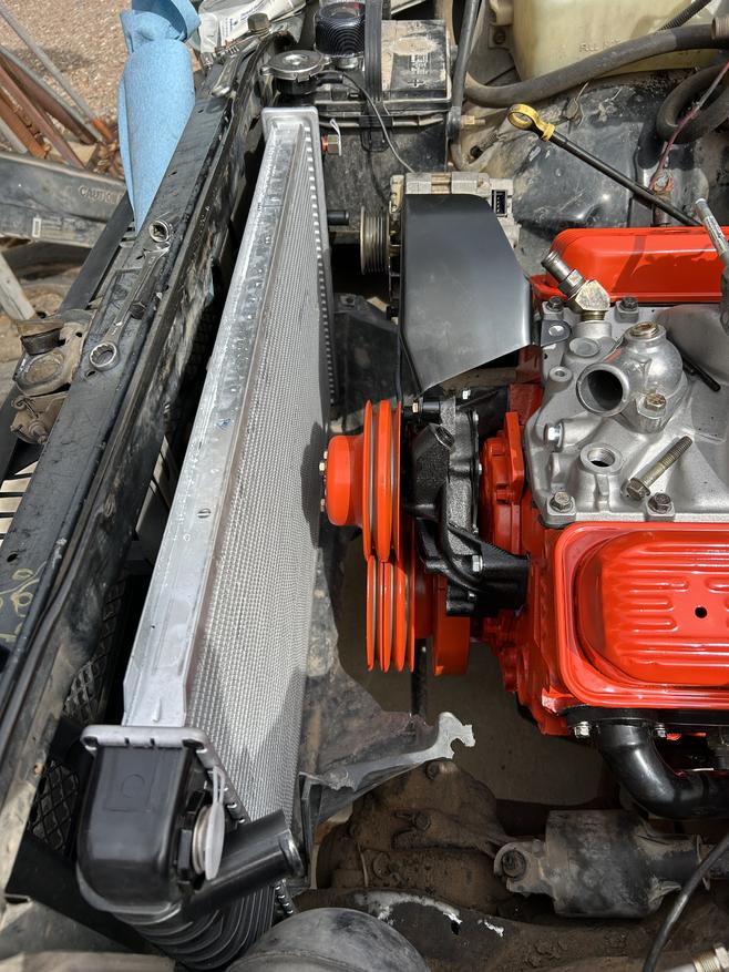

Also didn't care for the issues I was running into using a 2nd gen radiator. It fit, but it didn't have a bung for the heater return like the first gen's do, and my water pump doesn't have a bypass either so I sold some stuff and snagged a new radiator for a 1st gen 4.3. Bonus is the core is 1/4" thicker than the others so I'll take it.

Pulleys painted, and valve covers. Gotta say, Chevy orange is good.
but glad I made the water pump black. The contrast is good. Also started thinking about throttle linkage and alternator mounting. 99% sure I can use the original alt, but not with the $9 bracket for older style jobs. A turnbuckle bracket from Amazon should do the trick though. It almost works, but doesn't leave enough room for any real adjustment
if I have it in any position other than all the way out, the alt fan hits the bracket. Also the bracket requires modification or a secondary bracket to bolt the back of it properly to the intake.
