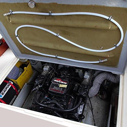

How about something like this to stop the fire if it starts.
