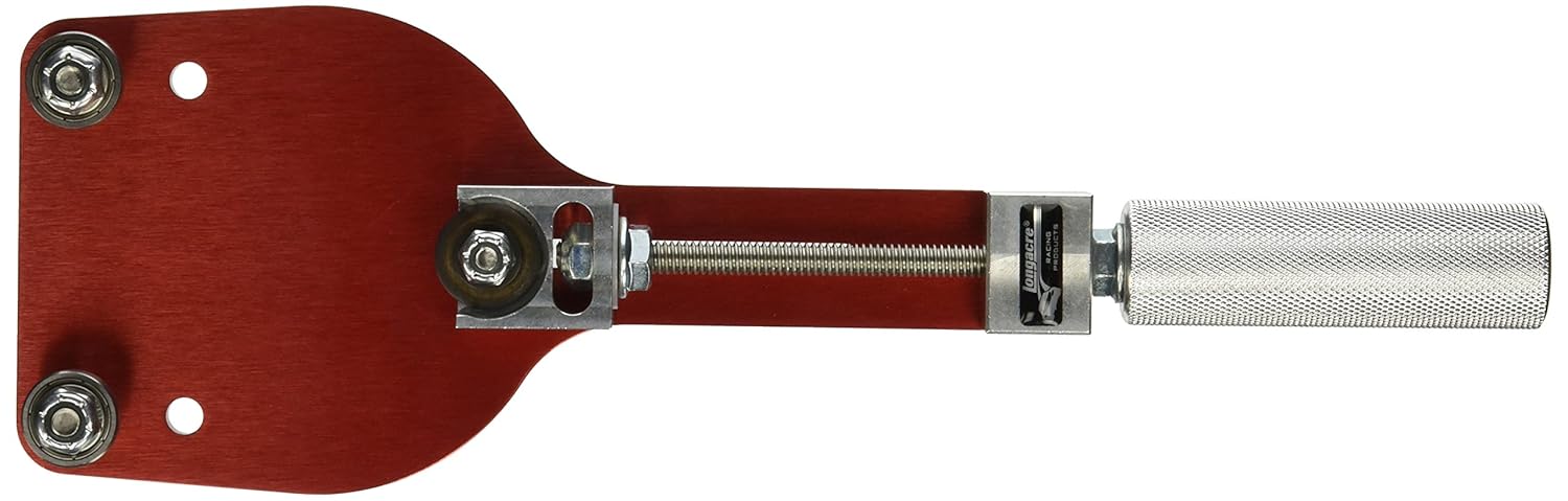

If you're cutting a lot of oil filters open you want one of these:

5/1/16 2:23 p.m.
^this
You'd be amazed at how much pain results from a jagged piece of oil soaked sheet metal tearing into your hand. You can also be certain that you aren't contaminating the filter with pieces of the metal you're cutting away.
You need to get the element out of the filter and spread out on a table. I've had many that looked okay at first glance and were filled with bearing material deep down in the pleats. Also bearing material isn't magnetic so your magnet trick won't work.
