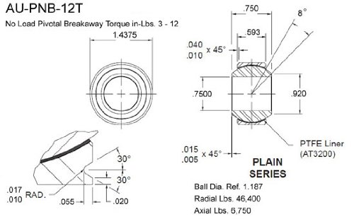

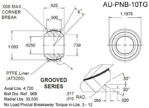

I'm working on a design for custom upper shock mounts for my Solstice - these will be one-piece aluminum units with spherical bearings pressed into them for locating the Koni damper shaft. I also intend that the upper spring perch will move with the bearing to keep the springs square to the direction of shock travel (similar in design to these), so that means that the entirety of the compression force at each corner will be acting on the spherical bearing.
I'm looking at using either Aurora PNB-12T (5,750lbs static axial load rating) or PNB-10T (4,720lb static axial load rating) bearings. I'd prefer to go with the -10T bearings as they are slightly smaller and will be easier to incorporate into the design (meaning a little more ultimate shock travel), but I don't know how much that extra ~1k of axial load rating is critical. Assume about 750lbs per corner at rest. Since I'm not an engineer by trade I don't know what I don't know about this. Should I just use the -12T?

@Knurled - the -12T is a .75" bore unit with a ball diameter of 1.187":
The -10T has a bore of .625" and a ball diameter of .968":
