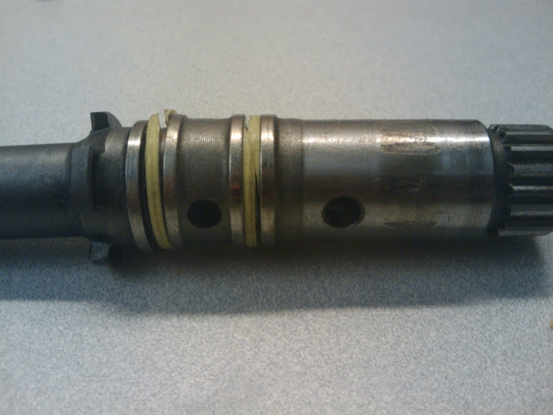

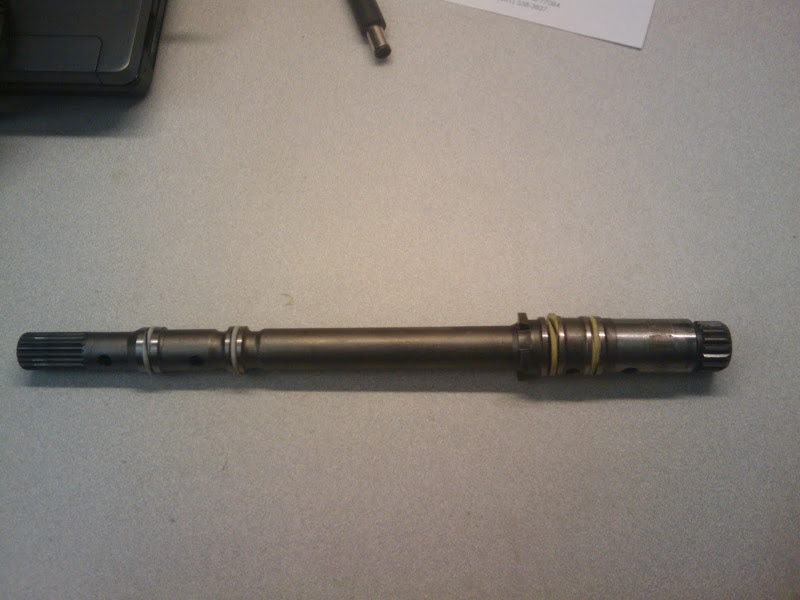

Im going to give you an actual nuts and bolts answer and say that the pump shaft snapped.
On those transmissions the pump is not the first thing in the bellhousing, it is actually at the END of the case, and there is a shaft about as thick as your pinkie that goes from the torque converter to the pump that drives it. They are prone to breaking.
Then you have no pressure, so nothing engages, and every range except park feels like neutral.
And the repair for this is easy...
Buy a Camry
I kill me!
Yup, pump shaft is broken.
Yes, I have one on my desk at work. I use it to threaten users when they do stupid E36 M3.
