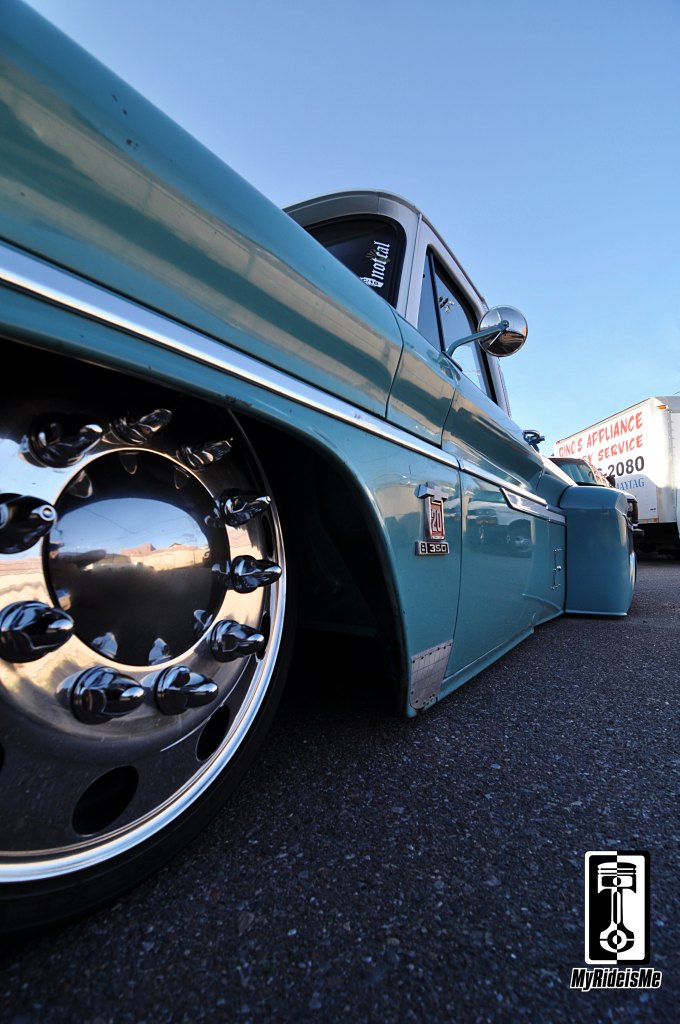

Curtis73 (Forum Supporter)
4/8/24 5:43 p.m.
In reply to MyMiatas :
I love that look.  Here is my GRM Pinterest inspiration photo album.  This kinda thing, but under a Bonneville.
Check Out This Dropped And Tucked GMC Sierra Dually: Video
Custom 1964 Chevy Dually - Hammered on 22s | MyRideisMe.com
Chevy dually.. | Lowrider trucks, Chevy trucks, Custom chevy trucks
House of Hotrods Goes All-In With a '64 Dodge D200 Power Wagon Crew Cab |  Fueled News
narrow dually axle at the rear end
LANDSCAPER-85 c-30 build | GMC Truck Forum
