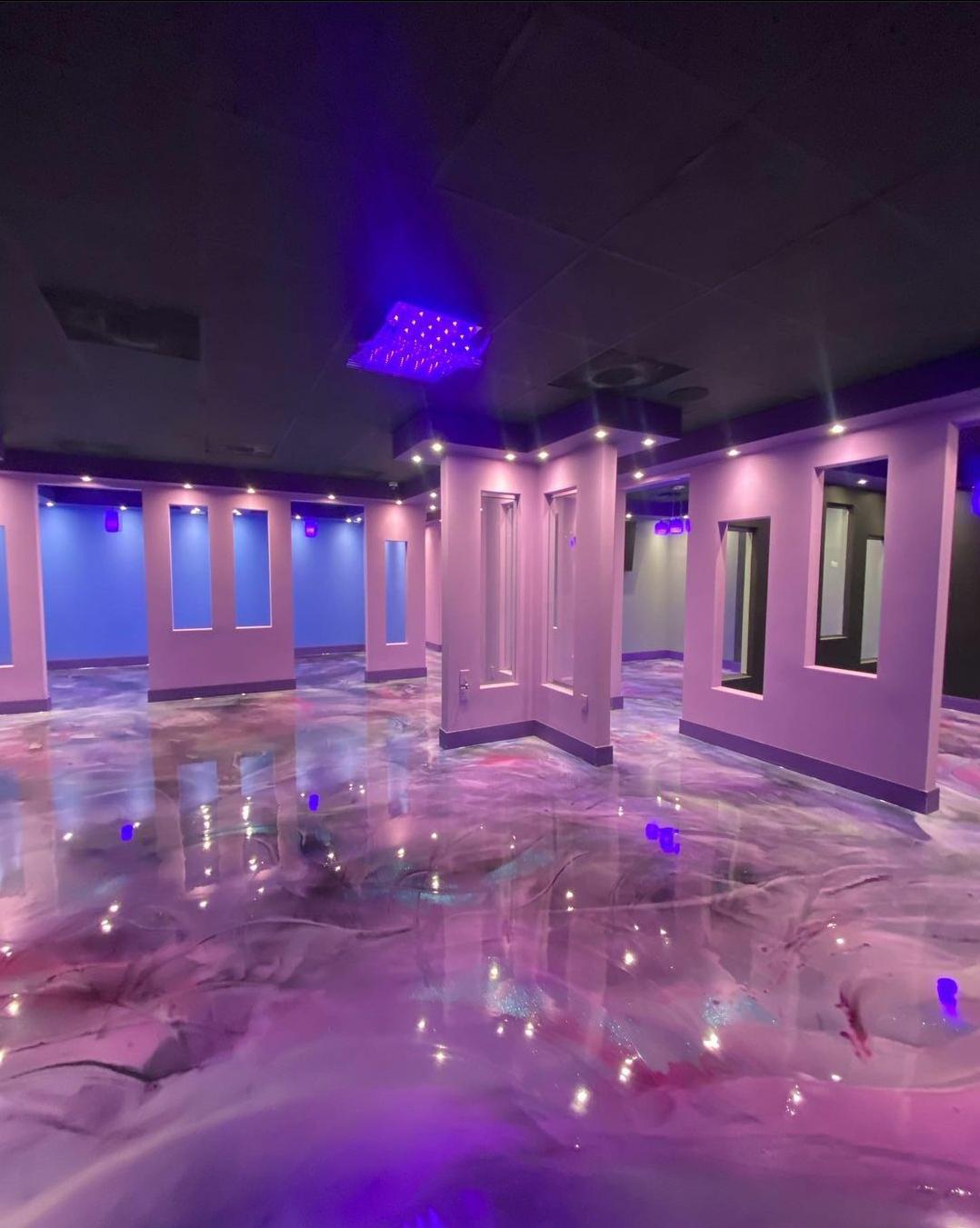

So this guy does epoxy floors (he does counters too) and they come out super fancy and nice.
My question is how sustainable are epoxy floors? What stains them or ruins them?

The pics posted dont' look like he does it, but everyone I've seen basically uses golf shoes to give a little texture and interest to the colors.
