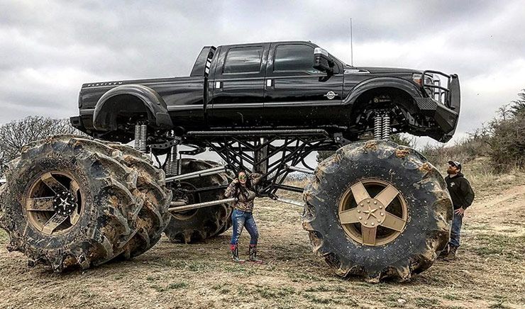

9/7/18 8:21 p.m.
In reply to stanger_missle :
You think that's  expensive?  In predict in 6 months you'll have "transformed" into this:

Scwinggg!

Go big or go home.
Apparently this is the only way to catch a woman's eye here. So.many.brodozers frown
