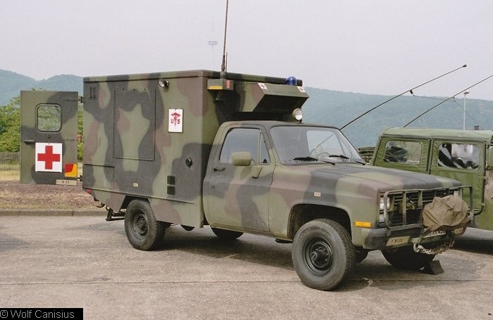

Or CUCV Ambulance, radio, or similar military "box" trucks? They came in Chevy and Dodge flavors.
Or a more modern 4x4 Ambulance?
PHeller
PHeller PowerDork
12/7/15 10:59 a.m.
bigdaddylee82 wrote: Or CUCV Ambulance, radio, or similar military "box" trucks? They came in Chevy and Dodge flavors.
Whoa. I want one of those.
