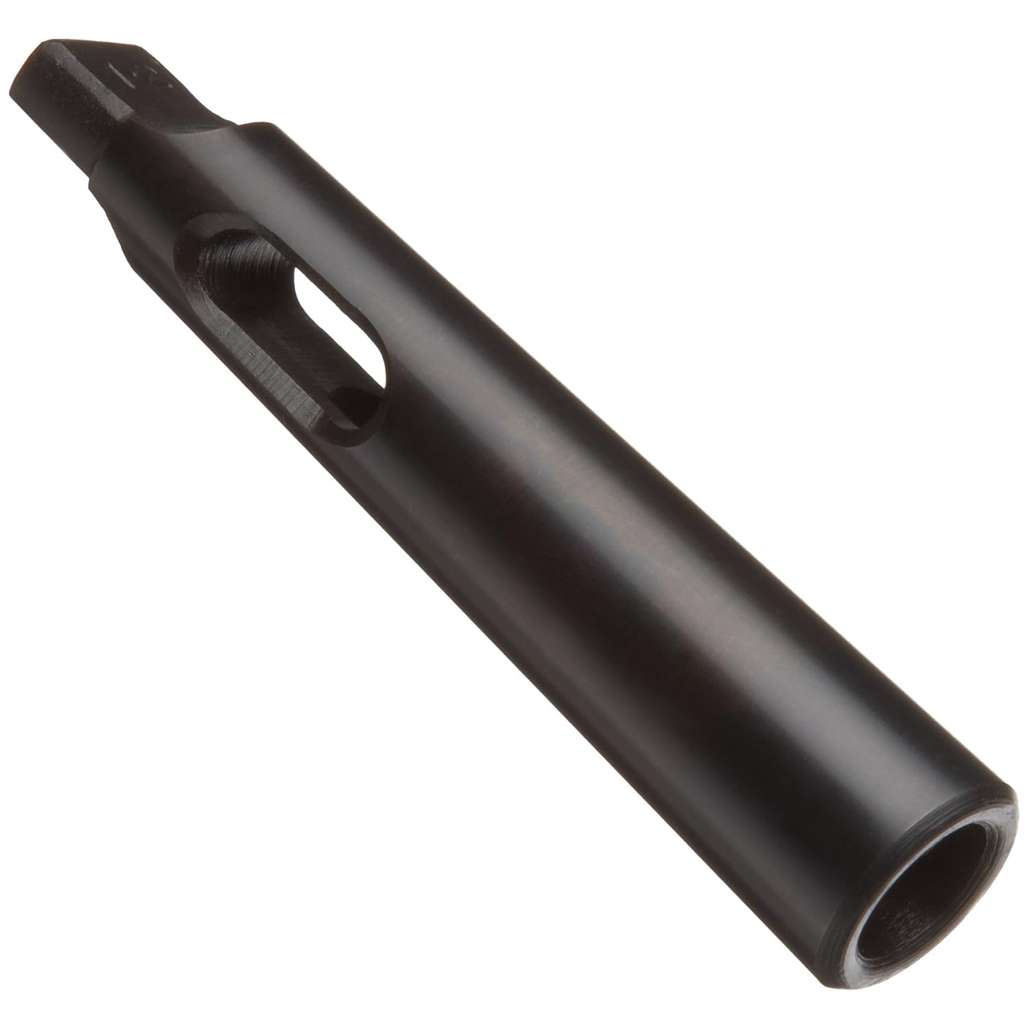

4cylndrfury wrote: question(s): How do I know what taper I have on my spindle? Is it possible to mount a 3 jaw lathe chuck on the same spindle? How do Ichange chucks? just pry it off the spindle with a ball joint fork? (kidding...sort of)
  1. check the manual
  2. why? get a 5/8" or 3/4" chuck
  3. If it is tapered (some screw on) , pull the quill all the way down. there will be a slot to insert a "wedge" to removed the chuck. it's a pressure
1. check the manual 2. why? get a 5/8" or 3/4" chuck 3. If it is tapered (some screw on) , pull the quill all the way down. there will be a slot to insert a "wedge" to removed the chuck. it's a pressure this is the "wedge"
The "Wedge" is called a drift. The tapered shaft assures the spindle is centered. The taper is a Morse taper (usually).
Larger presses (doesn't mean yours doesn't) have a threaded rod that comes in from the top. It threads into the top of the chuck and tightens the chuck up into the female taper.
Look at the top photo: You see the outside of the drill press column and the hole where the drift goes into. You'll see three distinct pieces in there. The center one is an adaptor that allows a #3 taper to fit inside a #5 spindle.

5/21/12 9:54 a.m.
This may help with adaptor I.D.
http://www.newmantools.com/tech/taper.htm

Thanks Dan, couldn't remember the term "Drift".
