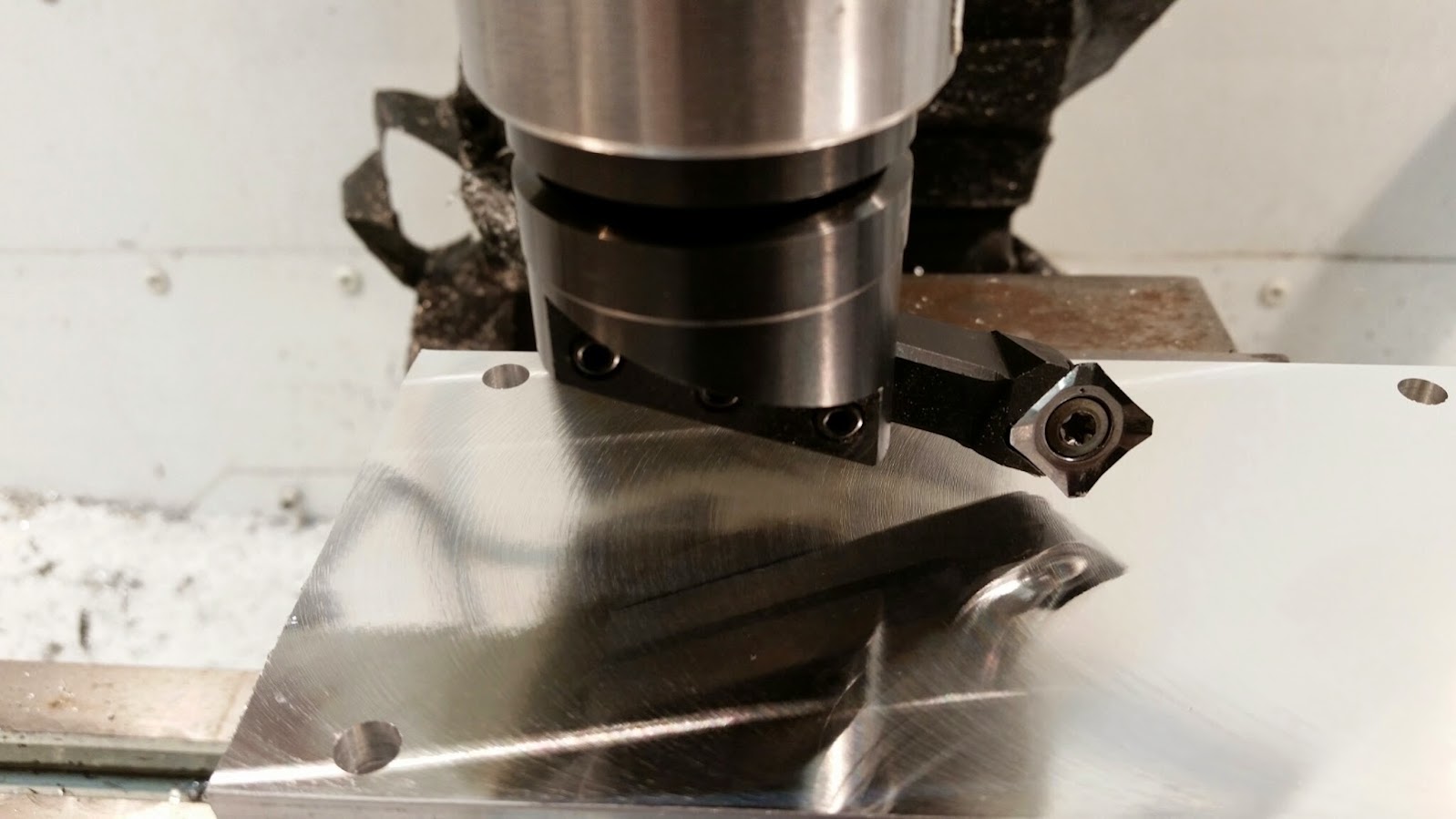

The previous owner had some issues with overheating at track days with even the stock 1.6L. I decided to do a coolant reroute to start.
I purchased most of the parts needed from BEGI. However, I decided to make the block off plate myself on my DIY converted CNC benchtop mill. (I had some stock perfectly sized and needed a simple part to test some upgrades to the mill.)
I took one of the gaskets from BEGI and scanned it on my flatbed scanner. I imported that image into my CAD program and traced around the image to create a DXF file. I took the DXF file and exported it into my CAM (computer aided machining) program and created G-code file to input into my CNC machine.
My machining strategy was as follows.
First I machined both top and bottom of the 6061 aluminum stock with a fly cutter to be sure the sealing surface was perfectly flat:
Then I drilled both holes into the part to attach it to the jig.
Next I cut out the rough profile with a 1/2" roughing endmill.
I followed that up with a 1/2" finishing endmill.
Next I chamfered both edges with a 3/8" 90 chamfer mill:
I flipped the part on the jig and repeated the chamfer code.
Here is the finished product:
To complete my reroute I picked up the GM hose from Autozone that many others have used. I may still end up upgrading to a better/newer radiator but figured I would start here.
