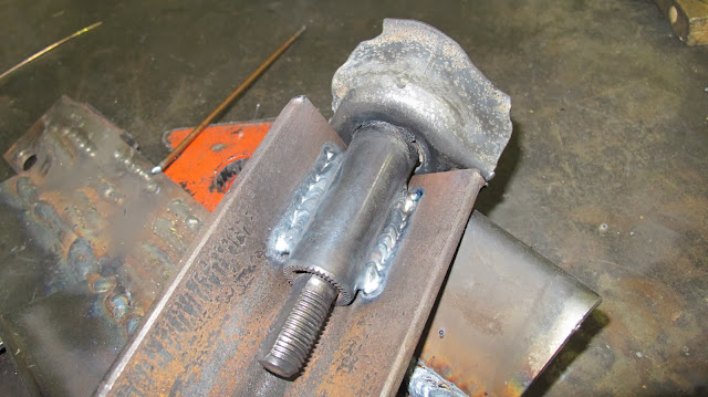

I wanted to get the last e-bolt out of the old subframe to have as a spare. Here's the process I had to go through to disassemble these:
Cut out the subframe around the bolt and press the steel sleeve and bolt out of the control arm.
Weld the sleeve to a piece of angle iron.
Get the sleeve really, really hot.
Torque the crap out of it with the impact gun, until if finally lets loose.
What a pain! At least it's something we should only have to go through once.
