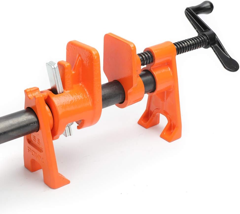

I had some fun with that on my Fmod recently.  Here are the tips on what got me through.
Slide hammer, PB blaster, really fine grit sandpaper (clean up rough areas you need to move something over).
For a few things I wound up using C-clamps as a puller.  I have some that use threaded pipe sections to lengthen, so I can make the length of the axle.
similar to below, but mine came from my grandfathers tools.
https://www.amazon.com/PONY-55-Clamp-Fixture-4-Inch/dp/B00C1YXCUS
2 of these, some pipe, and some metal pieces to go between, perhaps with a C notch cut in to go around the axle.
I dont think these would ding your challenge budget, they are useful for tons of things.
