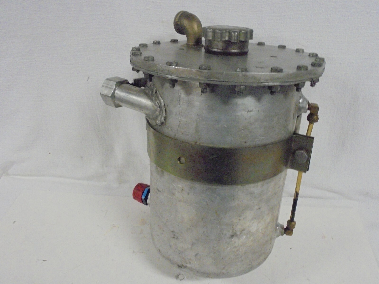

Since I procured this, I figured it needed something else.
At this point, the long block is assembled.  I am pulling a factory oil pump apart so I can "install" it.  I need to do some figuring on the tank location but the "trunk" may be the answer.

If you notice the rear area, I set the oil tank back there.  I think this may be the spot where it will live.
saying that, I need to remove EVERYTHING from back there.  Fuel tank, expansion tank, all of it.  The tank fits, but the mounts on the rear structure is busy.

Dry sump, so oil.
I have some aluminum that I plan to put as a cover over these pieces.  So they wont be exposed in the car.  More or less.
