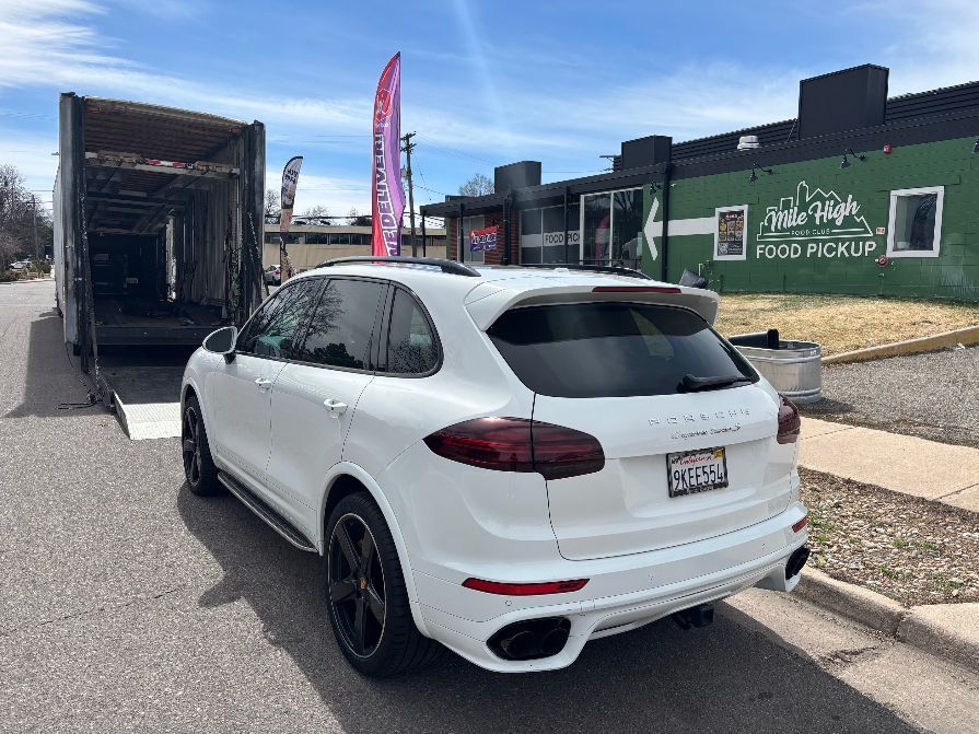

It showed up yesterday, early afternoon.  It's as clean as I hoped, some small rock chips on the front end, very light wear on the outside thigh bolster of the drivers seat.  Annoyingly the seller removed and kept the winter floor mats, cargo mat and Rennline phone mount that was in all the for sale pictures.  They're not super expensive to replace, but if they weren't going to be included he should've mentioned that.
After a few curse words got the Liftmaster 8500 to play nicely with Homelink, still need to program the other doors, but those always work fine. Also put on my winter setup, as we usually get several Spring snow storms here.  Happy I stayed with 21" wheels, even with these the radial clearance on the front brakes isn't all that much.
Spent 1.5 hours at the smog place yesterday, they were packed! Got the paperwork I need to register it this Friday morning at least. Still need to program two more garage doors into Homelink, hook up XM radio, go back to Discount Tire because they kept one of my center caps. They need to rebalance the front wheels, get new tpms sensors as the ones in the winter wheels aren't linking, go to the dealer and have them print out the service records, etc, etc...
Car drives like a dream, super smooth, fast, and sounds great with the factory porsche sport exhaust.  The brakes feel like they could stop a tank, they're incredibly powerful.
