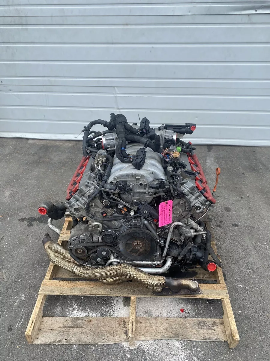

VWAG made a lot of V10s.  It is essentially two 07K five cylinders the way the 3.6 is two 1.8 16Vs.  Found in some S6s, S8s, R8s, and Lambos.  (It annoys Lambo people when you fix their engines with Jetta parts)
Downside, they may be tricky engine management wise, and they may not have an easy transmission solution.  And all power upgrades involve turbocharging.
Audi fives made up to 170-190hp naturally aspirated, that is a lot more power than many V8s wink

lol a 170-190hp V8 isn't worth it's scrap weight as a swap. Malaise era killed a lot of things.
The VW Group V10 sounds very complicated. Dual ECUs in a master/slave configuration, etc. The S85 is well documented as a RWD swap, solutions exist for many of the problems presented. Both are right on 530lbs, about the same weight as a 2j with the turbos. Unfortunately, I know that's enough weight to ruin the feel of the car, lots of 2j swaps don't last in FDs for that reason. I can't imagine a V12 being lighter or easier hahahaha
