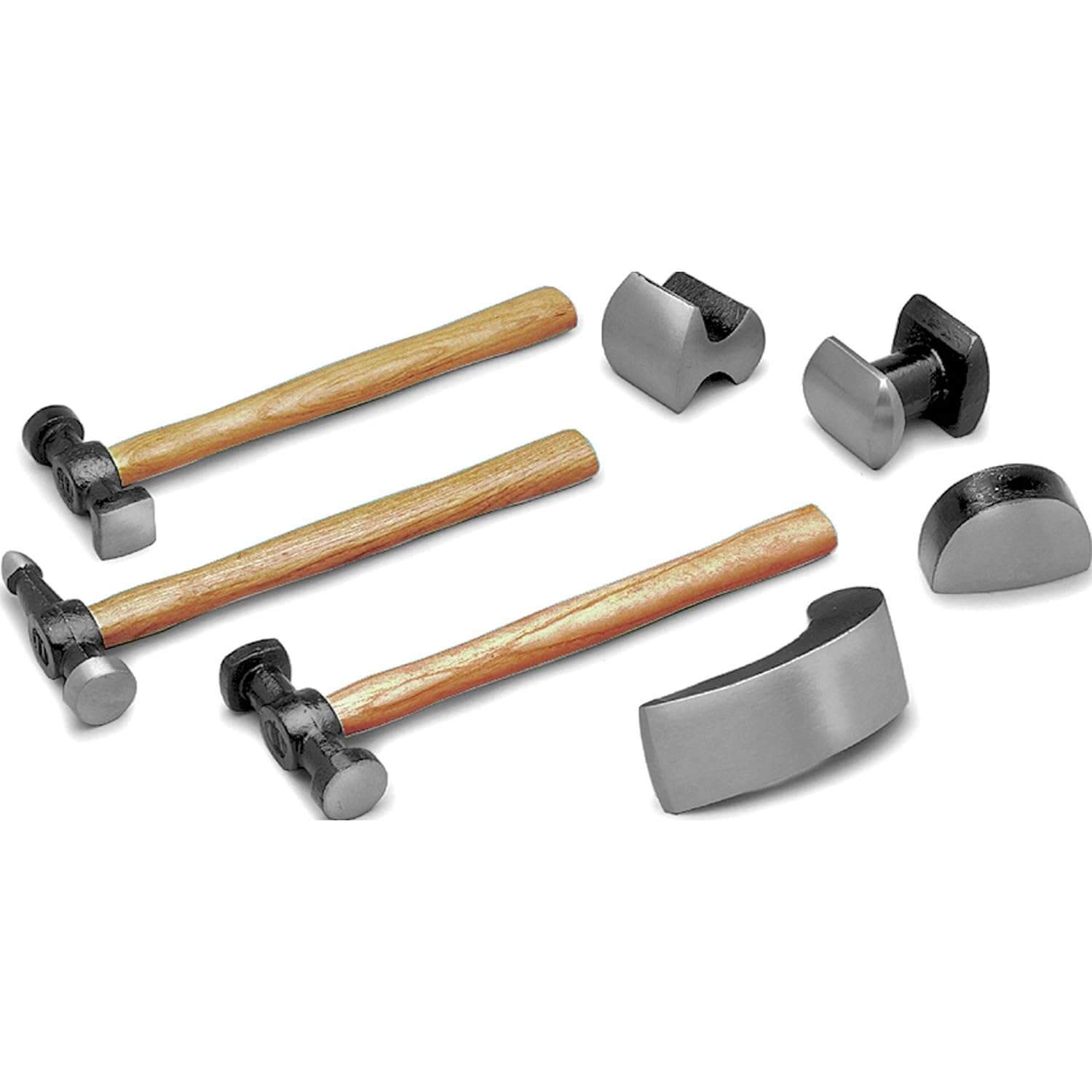

What's a dolly?

Hammers on the left, dollys on the right, all specially designed for body repair work. You put the dolly behind the metal you're hammering on.
http://www.amazon.com/Performance-Tool-W1007DB-7-Piece-Repair/dp/B000N37CYG
