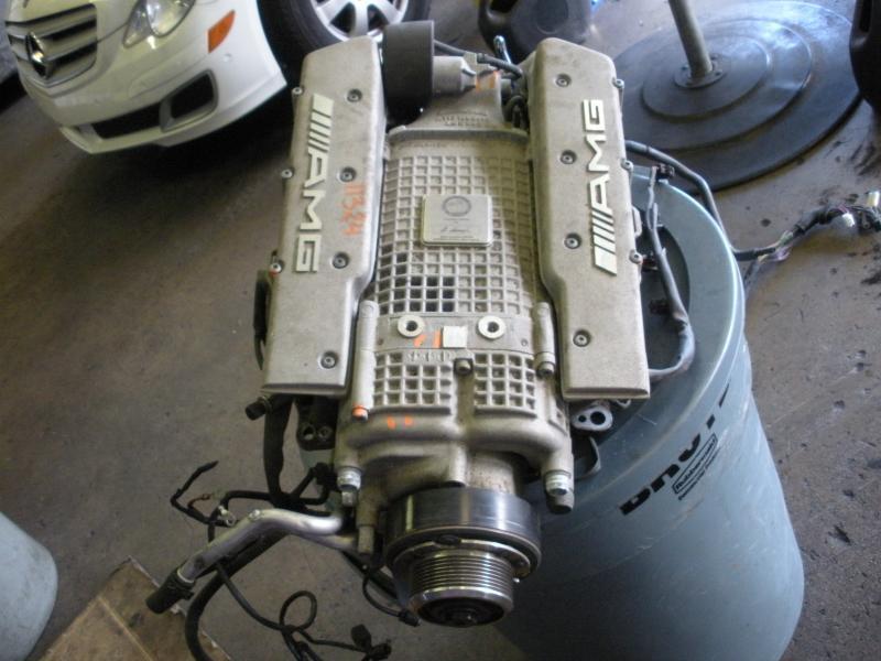

yes the blower im talking about is AMG specific, in fact it's this mean bastard of a blower (with some pipes on the side)

That ones going to move some air but it would be a hell of an effort to fit it all under a hood I feel. What car you planning on strapping that to?

chiodos wrote: That ones going to move some air but it would be a hell of an effort to fit it all under a hood I feel. What car you planning on strapping that to?
bmw 540i, whose hood is already somewhat restrictive. of course there is always the infamous powerdome hood to use. i'm not concerned about vertical space, i'm much more concerned about fiddly bits like what throttle body to use and how to set up the intake
