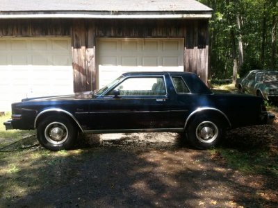

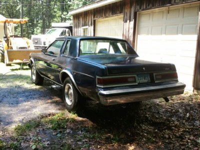

I have an 1982 Córdoba. 360, four barrel, tall geared rear end, something like 2.11, not sure anymore.
Not quick by modern standards, but it’s like driving a couch. Suspension upgrades can be found in ex cop cars, any power upgrades are the same with any la engine, transmissions are the same 904, 727 that have been well established
I ran into title issues early on, so the project has stalled for now. That’s all I have to offer at the moment.

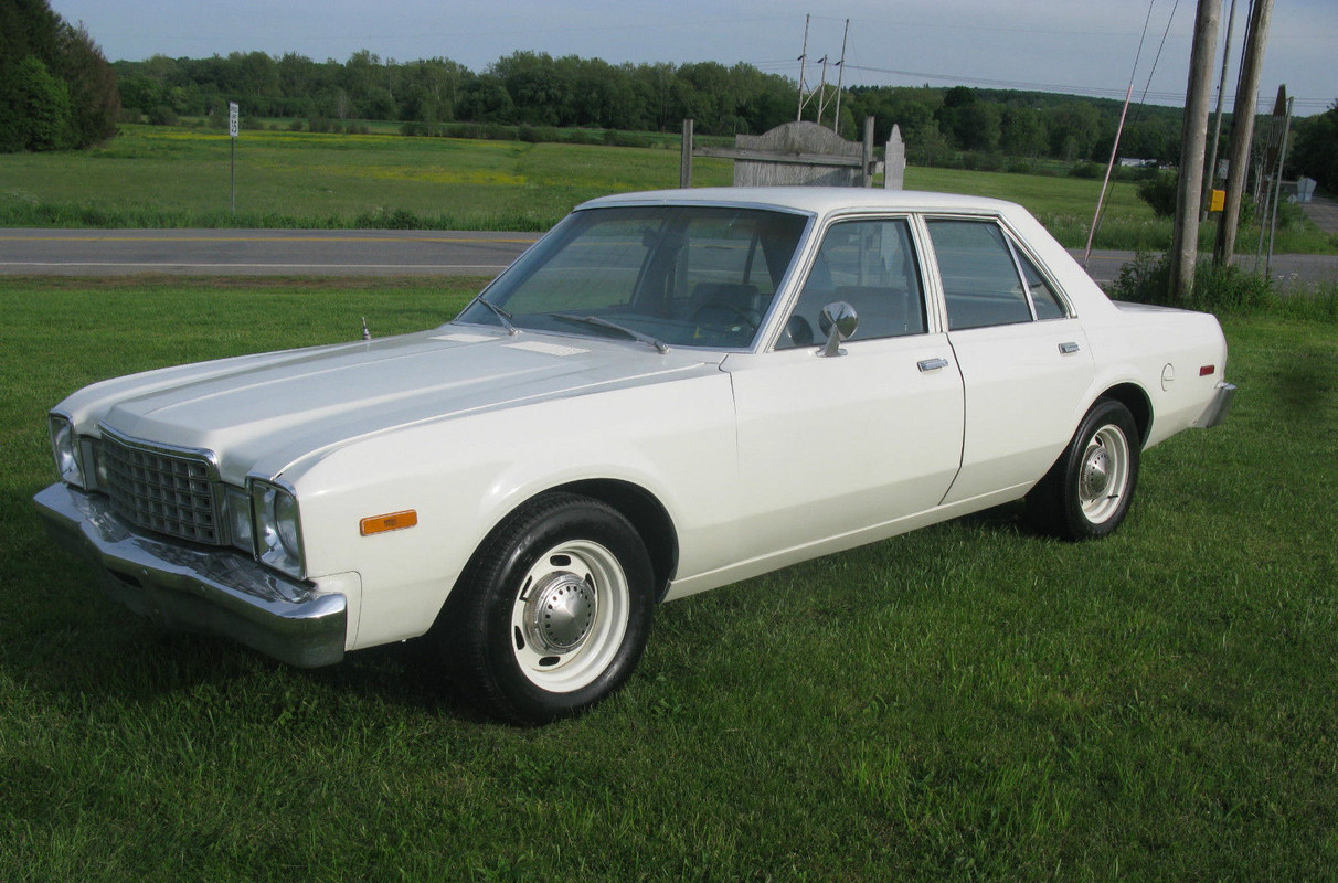

My aunt bought a brand new first year (1976?) Volare Premier wagon just like this one:
The whole area below the fuel filler had completely rotted away by about 1980.
I can't imagine that there are any of them left.
