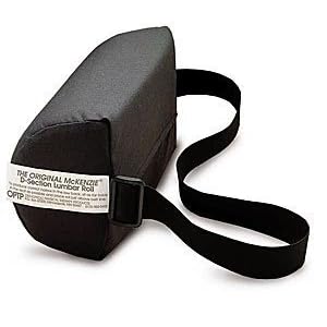

Get a McKenzie Lumbar Roll if you want to be balla : http://www.amazon.com/Original-McKenzie-D-Section-700-Lumbar/dp/B000GPM520/ref=pd_sim_ba_4
It has velcro on the reverse side and will stick to the fabric on your seat. i have one on my Cobra Monacos (very flat) and it helps a lot.
