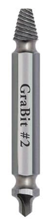

If that fails you could give this a shot:
http://www.thegrabitstore.com/Pages/howtouse.aspx
Disclaimer: I have never used this product and can't comment on how well it works.

1/16/14 2:53 p.m.
For screws such as you describe, I have had very good luck with this product:
http://www.amazon.com/Alden-8430P-Grabit-Damaged-Extractor/dp/B000H6PM32
No need to drill very deep, just enough for the bit to grab, then back it out. Works fine with a cordless drill/driver.
