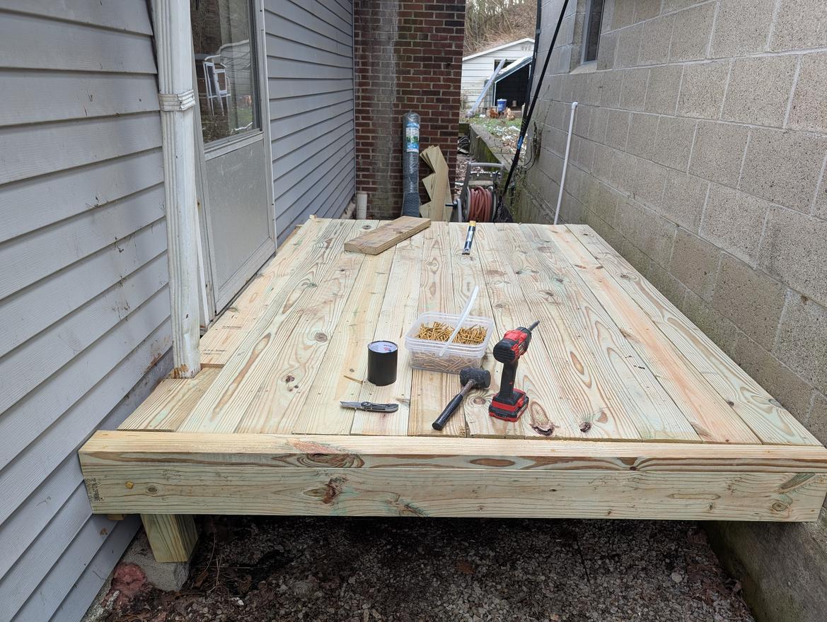

Well there's a deck, and steps. The easy part is done, now I gotta build the ramp.
Nothing behind the siding, big surprise. I kind of over built everything as a result. And before anybody gets their panties in a twist about that angled 4x4, it's purely for decoration. Mine and Dana's combined 500lbs jumped all over it and nothing moves even a little bit.
Only took about 6 hours to get there. A framing nailer would have helped. So would having any help other than Dana. But she did good.
I need to figure out how to cut the end of the ramp frame so it's flush with the deck, buy a DeWalt miter blade tool because Lowe's doesn't sell them and nothing I have fits, and get it all installed. Hopefully soon. Weather pending.
OHSCrifle
OHSCrifle GRM+ Memberand PowerDork
3/29/25 7:14 p.m.
In reply to RevRico :
What do you mean by:
Are you building toe rails on the ramp or something?
Regardless - I recommend you scribe the stringers and trim the bottom edge off so they can land on a sacrificial 2x laid flat - so when that one rots you can replace it easily.
SV reX
SV reX MegaDork
3/29/25 10:25 p.m.
In reply to OHSCrifle :
I'd add to that...
Land the bottom of the ramp (sacrificial 2X) on a bed of gravel.  It will drain a little better and the wood should last a bit longer.
