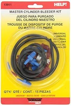

I bought this Dorman kit for bench bleeding. If anyone from Dorman is reading this, I have a question: why would you use black tubing here? You cannot see if you are getting solid, airless fluid through a solid black line. Moronic.
Luckily, I had some clear tubing in the garage, and the rest of the fittings/clips do the job just fine.
There are many methods to bench bleed, but I just filled it with fluid and pushed the piston in with a screwdriver until the air bubbles went away in the lines. As you can see (which you 100% couldn't do with the line supplied in the kit) there's just solid fluid in those lines. Time to pull the old master cylinder and get this thing on the truck.
