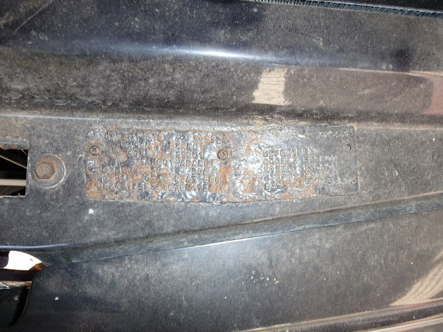

SilverFleet wrote: Is there any way to find out without the plaque?
There there a plaque under the hood attached to the radiator core support? If so it will have the engine number on it.
I know there's a way to determine the series number from the engine number on the Shelby Dakotas using a formula. Don't know if it's the same for the other models. The guys at Turbo Dodge should know.
There there a plaque under the hood attached to the radiator core support? If so it will have the engine number on it. I know there's a way to determine the series number from the engine number on the Shelby Dakotas using a formula. Don't know if it's the same for the other models. The guys at Turbo Dodge should know.
I noticed those body tags on the core support. It's funny, there's 2 or maybe even 3 of them all screwed on there with Philips head screws! I figured that someone might have done this to make a clone, but then I realized that the cars were converted at Shelby, so they may have done this. Here's a pic from the old owner of them:
I'll get a better pic the next time I'm where the car is.

In reply to SilverFleet:
A little charcoal rubbed over a piece of paper may give you a readable copy of this. Your mileage may vary....

SilverFleet wrote: I noticed those body tags on the core support. It's funny, there's 2 or maybe even 3 of them all screwed on there with Philips head screws! I figured that someone might have done this to make a clone, but then I realized that the cars were converted at Shelby, so they may have done this. Here's a pic from the old owner of them: I'll get a better pic the next time I'm where the car is.
On my Shelby Dakota there's a silver tag on the passenger side of the core support. It has the CS track logo and the Shelby info with the engine serial number.

In reply to Rob_Mopar:
There's a Shelby American federal emissions sticker on the car. Maybe the info I'm looking for could be on there.
