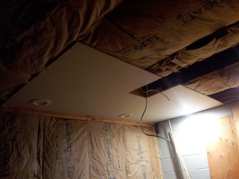

It's still sitting in line behind work on the garage so I'll have a place to do it. I got a few more sheets of drywall up this weekend, so there's progress after a fashion... Just not on the car itself. While not screaming along, a lot's gotten done out there.
Relevant to my last post, I did figure out that (I think unlike the '64-'65 cars), the window frame isn't an angle-adjustable two-bolt deal, but in fact just rosette-welded on the end panel above the latch.
I'm finally looking at what's left to do on the shop in terms of weeks instead of months or years, so hopefully a better update won't be so long in coming this time.
The ceremonial first sheet from a few days ago: (yes, I totally fouled the corner of the sheet wedging it into place)
