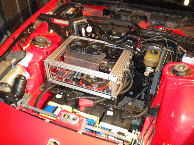

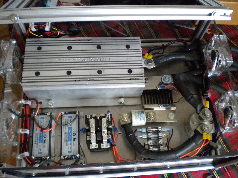

so i thought i'd update a little bit.
I am currently making a new electrics box that will be directly over the motor. Its going to be made out of extruded aluminium and clear polycarbonate. Hopefully I will have this whole box done with in the week. Just ordered some fans for it along with looking to purchase some temperature gauges.
-Sean

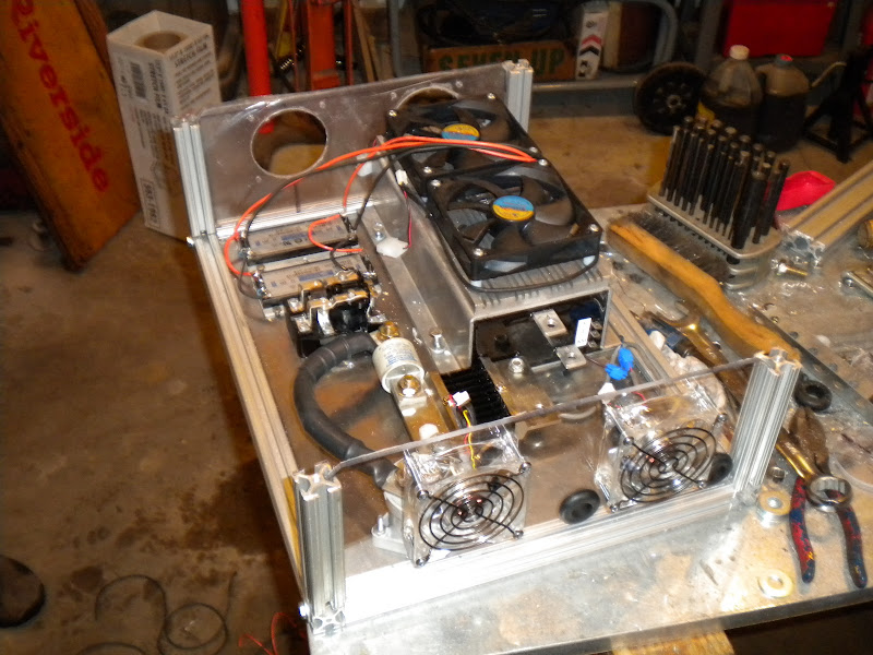

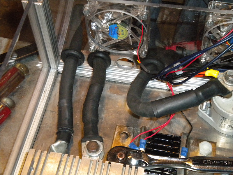

Finished up all the wiring rework today. Here are some pictures Before:
After:
Building of:
The rest of the pictures are on my Picasa account at: http://picasaweb.google.com/sean.kle...eWiringRework#
