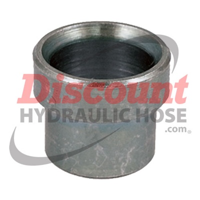

So you have a 3/8 steel tube that you flared, then added one of each of these?
I'm going to guess that if this is correct, that there is a problem with the flare. Not deep enough, not centered, not straight, ect. Or, since you mentioned tightening the piss out of them, the flare could now be split or cracked.

In reply to HappyAndy:
Aluminum, but yes.
I took it apart earlier today, thinking burr, crack, etc. None. And the flare appears to be the same size and centered on the sleeve. I'll happily look again though.
Yugo: not compression. Actually a single flare.
