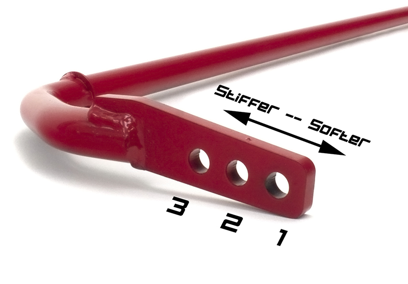

I think your idea could use some improvement, but you're definitely on the right track to a workable concept - sway bar end links that have adjustable stiffness with a pneumatic mechanism.
But now you have to ask yourself how practical this idea is? You'll have to compete with much simpler systems, like cable-actuated rotating blade adjustable sway bars:
And multi-hole/slotted hole adjustable sway bars:
Also your idea, if applied to both axles, is almost as complicated as a full hydraulic FRICS setup which offers a different league of performance:

I really like the blade style arms. Ever priced those things out? Like $350+ for just the arm! I was originally mulling over these before coming to the conclusion there's no room on my Mazda2 for that. Plus a custom sway bar itself would need made to accept that arm due to multiple bends/etc.
As for bars with multiple holes... If that were an option I'd try it. The problem is I'm fairly sure I need a softer than stock front bar. Nobody aftermarket makes softer than stock. I suppose I could weld tabs to my control arms to change the motion ratio to significantly lower than on the strut, but that's still just a guess.

You shouldn't weld on a sway bar since it could affect the metal's "springiness," but you could clamp/glue multi-hole adjustable ends onto the stock sway bars.
