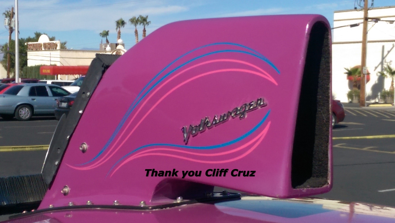

And now for a completely tongue in cheek answer!
Put one of these in the MIDDLE of your hood!  You won't be able to see around it but just THINK of the cold, clean air the oil cooler will get!
