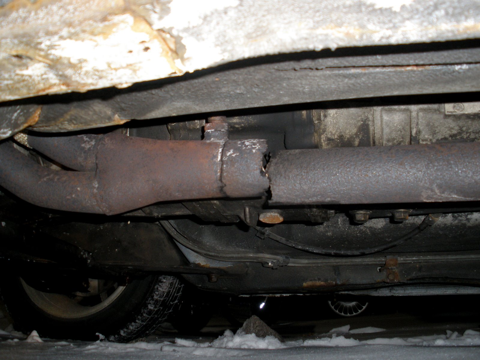

Alan Cesar
Alan Cesar Associate Editor
3/26/13 11:28 a.m.
My experience with header wrap through lots of commuting in Chicago winters and road salt:
Lasted about a year before it broke like that. New stainless header, too—though not a name brand. When that happened, it was very, very loud.
Ojala
Ojala GRM+ Memberand Reader
3/26/13 2:35 p.m.
Good lord what kind of "stainless steel" did they pawn off on you?
Makes me glad to drive southern cars.
