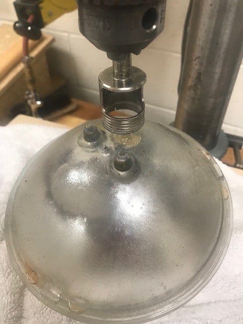

Some people actually cut a hole in a burned out sealed beam with a diamond hole saw in a drill press and use a 12v led lamp inside.       If you could manage to cut the hole off center, you would only have to worry about the depth of the sealed beam itself, and not the wiring sticking out of the back of it adding to the overall depth of the assembly.
There are also some OEM fog lights that are the correct diameter and a bit shallower that can be used if you shop around at the JY.
The aftermarket 12v LED lamps can run off of a "wall wart" and run the lower voltage (and amperage, thus lower wattage) wires that will be smaller than what you would need for 120v, and it will also be safer than running 120V up your wall.  Those 12v wires will a bit less obtrusive than line voltage wiring.
