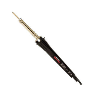

How many watts is your iron?
dyintorace
dyintorace GRM+ Memberand UberDork
4/4/15 4:16 p.m.
1988RedT2 wrote: How many watts is your iron?
No clue. It looks like this, but much older and very used.

I don't think you want to rip that foil off. I think with a good bit of heat, you could still de-solder it. But not with a 20-watt pencil iron.
