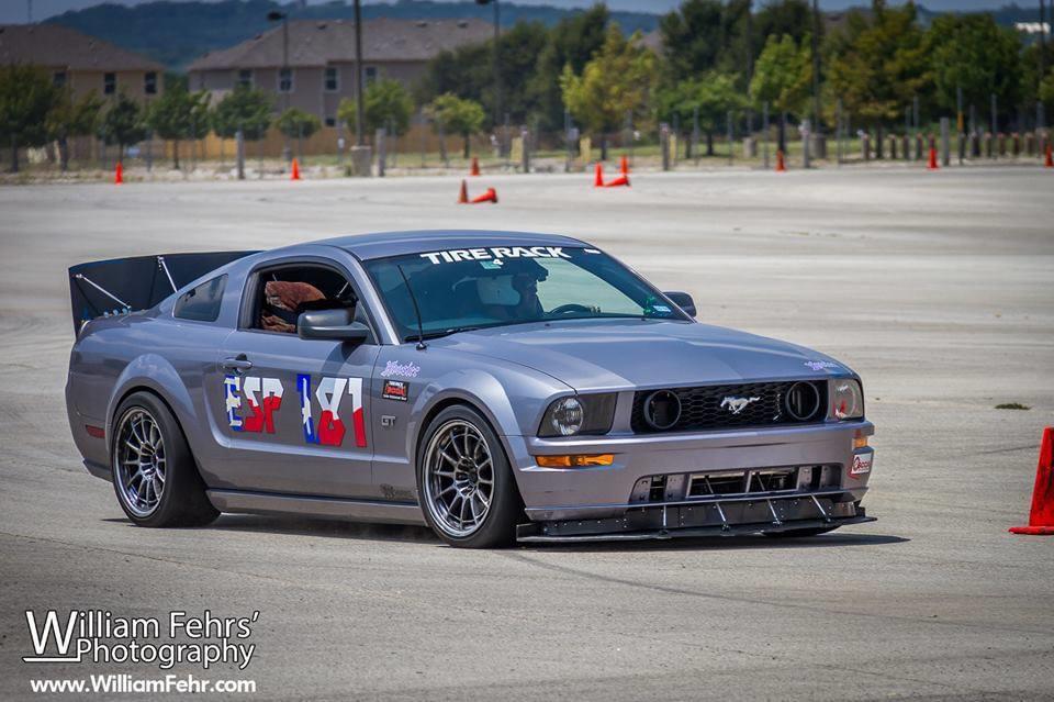

 If you look at this one, I went all the way out as far as I could to get the most out of the spoiler.  This was an ESP car so I think you have a little more available in XP.
As said, go big. To make full use, you need as much power to run it. If you can make the sides removeable on it, or adjustable do.  Then you can test and see if it's slowing or helpin you.
