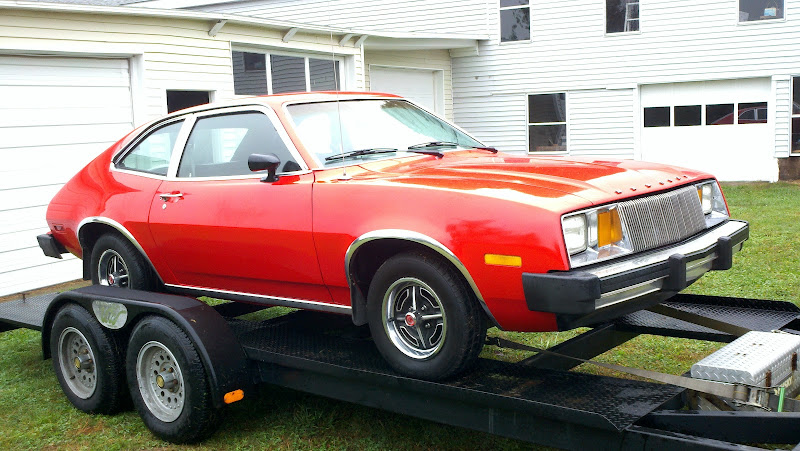

Brought this guy home today. 1979, has been repainted (I'm pretty sure by Ray Charles, with a brush), but absolutely 0 rust.
It stops and goes, and is overall in great condition. Plans are to make it turn and stop better, and then add as much horsepower as feasibly possible.

Those are the only Bobcats that are not uglier than the Pinto.
I approve.
(Recovering Pintoholic)
Woody
Woody GRM+ Memberand MegaDork
9/29/12 6:11 p.m.
Love that Bobcat.
