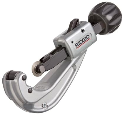

I bought a large size rigid plumbing pipe cutter that worked beautifully for straight cuts
