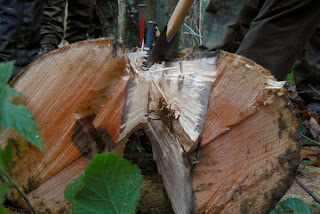

When you get everything home, split it into quarters. Somewhere on this thread is the mention of a youtube channel that I can't seem to find. On there somewhere is a video of them splitting osage. Watch that if you're interested. I've never done that, so I don't have personal pics, but I did find this:
Split in half, split those in half. If the tree is big enough, each quarter will have 2 or 3 bows worth of width on the outer surface. You can also bandsaw out another one from under that, but I don't have pics. The bowyers bible 1 has some great info and pictures about that, but I don't feel comfortable posting a copy of their stuff online. If you want those books and buy from "bois d' arc press" you're actually buying from one of the main authors directly. Bois D'arc is a name for the osage orange tree, btw.
