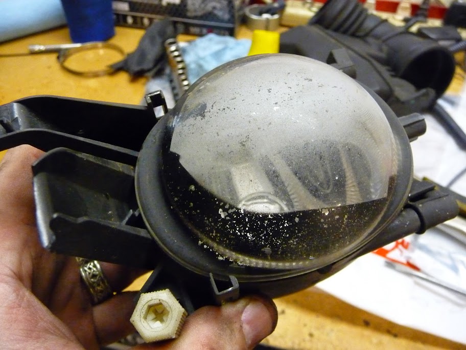

While I was down there doing that, I took a closer look at that fogged up fog light. Turns out it's not full of condensation after all. it's actually over spray from a rather shoddy front bumper respray job. So out it came to get wet sanded.
I started by removing these panel clips in the grill section.
One that is out of the way, you can get to these 7mm bolts, and just twist the unit sideways to remove it out of the hole.
Here's the offending light, removed and ready to be cleaned. I used 1200 grit, the 2000, then 4000, to polish it out.
Ahh much better, still has stone chips but it's 100% better in person.

You removed all the protective coating on that fog light when you sanded it. Hit it with some clear coat or it will start to yellow.

Sky_Render wrote: You removed all the protective coating on that fog light when you sanded it. Hit it with some clear coat or it will start to yellow. Also, what kinds of garages do such shoddy repairs to cars?!
It's a glass fog light so I won't have to worry about it yellowing. If it was plastic I would definitely shoot some clear on it.
