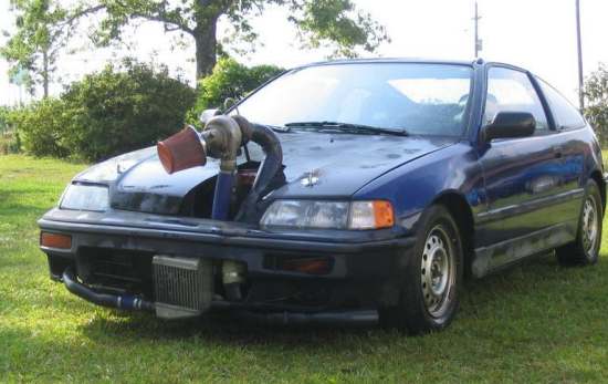

AngryCorvair wrote: flip the OE headers and put the turbo above the distributor, with a bitchin asymetrical hoodscoop!
He he he I actually really like this! The way the motor is angled the turbo would end up almost over the passenger side fender. LOL
This kind of eliminates any kind of the stealth effect I was hoping for.
dean1484
dean1484 Dork
2/11/10 2:08 p.m.
Hay wait lets just do this!!!!
Sorry could not resist!
Ohya it's the hood pins that really make it the schnitz!!!!
