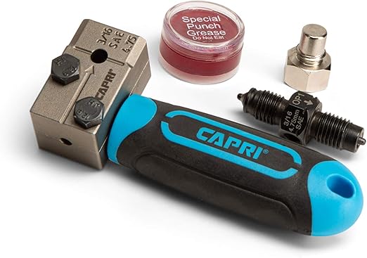

If you are worried about making good flares, buy one of these:
I tossed my other brake line flare tool as useless after trying one of these.

In reply to NOHOME :
That looks like a great tool, and shockingly affordable. I have made a bunch of flares that I think look good, but they're not factory quality and I've not done other lines before so I don't quite know how perfect they need to be vs "good enough".
I just finished my "hopefully" last brake job and have this tool (or one of the Amazon equivalent versions) if you want it I will toss it to you for however long you want it if you pay shipping both ways. Should end up half price I would think. It's for 3/16" (4mm) line.
Although it appears you may be done already.

+1 on that tool. Easy enough to do it even on the car if it comes to it.
https://grassrootsmotorsports.com/forum/grm/novel-and-affordable-brake-like-flare-tool/180562/page1/
My advice for it is to not tighten down the tool TOO MUCH on the line you're working on, it will crease the line and screw things up. It's otherwise foolproof, as promised
